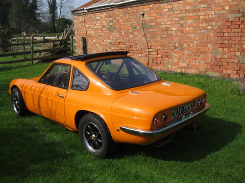

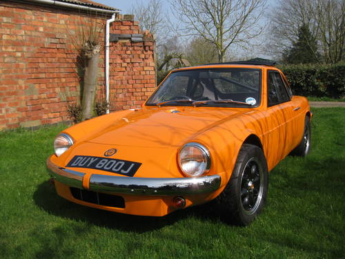

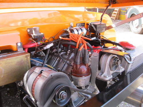

Pics of my G15 :)
Pic 3
g15 web shot 2.jpg (38.27 KiB) Viewed 2945 times
Pic 2
g15 web shot 3.jpg (37.56 KiB) Viewed 2945 times
My Ginetta
G15 web shot.jpg (39.67 KiB) Viewed 2945 times

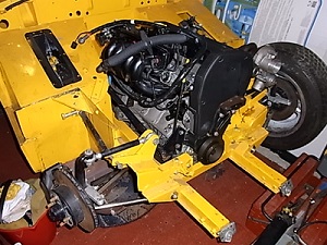

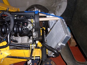

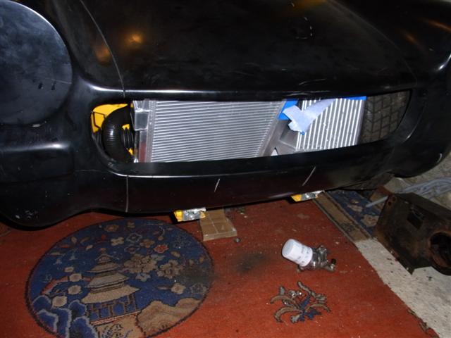

Some pics of my Mk 2 Healey Sprite (work in progress). So far I've completed:
Rear suspension - Narrowed RX7 axle (vented discs), coil over shocks, anti-tramp bars, panard rod, adapted prop shaft (RX axle to type 9 gearbox).
Engine & gearbox - In car, turbo had to be mounted high i.e. manifold turned upside down for space, but it still fouls the front suspension geometry. Engine will be chipped for approx. 200 bhp with similar torque level.
Front suspension - Work in progress. First attempt didn't work so having a re-think, I'm going to have to fabricate upper & lower wishbones for coil overs (possibly similar to Triumph GT6)
Cooling - work in progress. I was going to use Renault 5 turbo rad and intercooler (see photo), but may have a bespoke set up made.
Body - Original shell has been blasted and painted (powder coat) and is in great shape rust wise, apart from some minor dents (its been stored and moved around a lot). I'll got a GRP front end (bonnet & wings) for lightness. Car should be about 700 kg.
Interior - Stock dash, MX5 seats, roll bar (but may go for a full cage).
There are a few 1.8 K series conversions, but only one other turbo (New Zealand) that I know of. Good slightly tuned non turbo conversions with about the same bhp do 0-60 in about 4.5 seconds, so I'm hoping mine may be a bit quicker (if I can get the tyres to stick) due to having 25% extra torque that the turbo brings!
Thanks for the comments. Cheers, Karl
