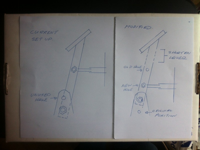

The Westy factory set up does not give a smooth pull away but it can be adjusted. I made this mod shortly after getting my Busa some time ago but as there are a few more BECs in the club, or so it seems, I'd though I'd share it.
The push rod that goes through the bulkhead needs to be moved as close as possible to the pivot point so the lever has more travel for a given movement to the clutch. The Westy has an unused hole on the floor mount just above the above one that the foot lever is attached to, move the lever up so the top hole is used, the push rod can then be moved down the lever as far as possible and a new hole drilled to take it and then the lever can be shortened once you're happy. The bike clutch is very light anyway and this may make it even lighter, I added a strong spring to the mechanism on the master cylinder side of the bulkhead to give it some "feel" and make sure the lever is returned ok but that is optional.
This diagram should make it clear:

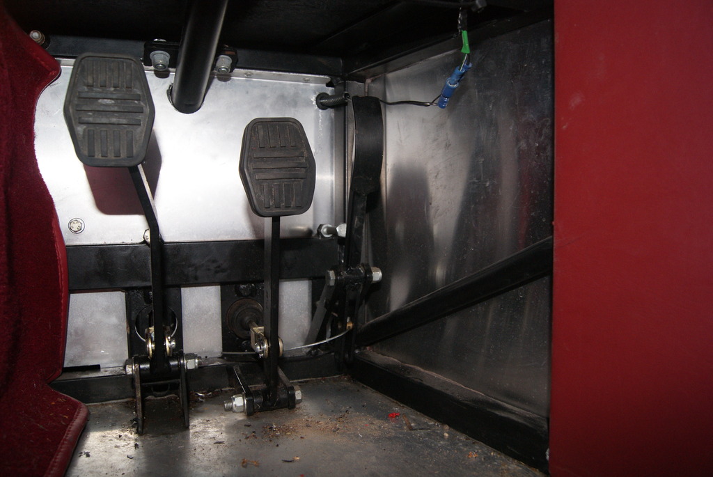

Pic of the modified pedal before it was shortened:

The exact same principal was used on my brake pedal, when I made my car 19 years ago,
As the braking was not up to what I was expecting!
so by altering the pivot and fulcrum point nearer each other, but retaining the normal pedal gave more feel, and an increase on braking buy a good margin, probably 30% better
The same principal could be used on a heavy clutch pedal

I'm not sure this will work on your car Tony as it uses the Nova/SBD clutch slave. The original Westfield setup used what looked like a (original) Mini clutch slave cylinder on a fabricated bracket (that break).
I would try uprated clutch springs in the basket before modifying the pedal if you want to add some more weight to the pedal.
