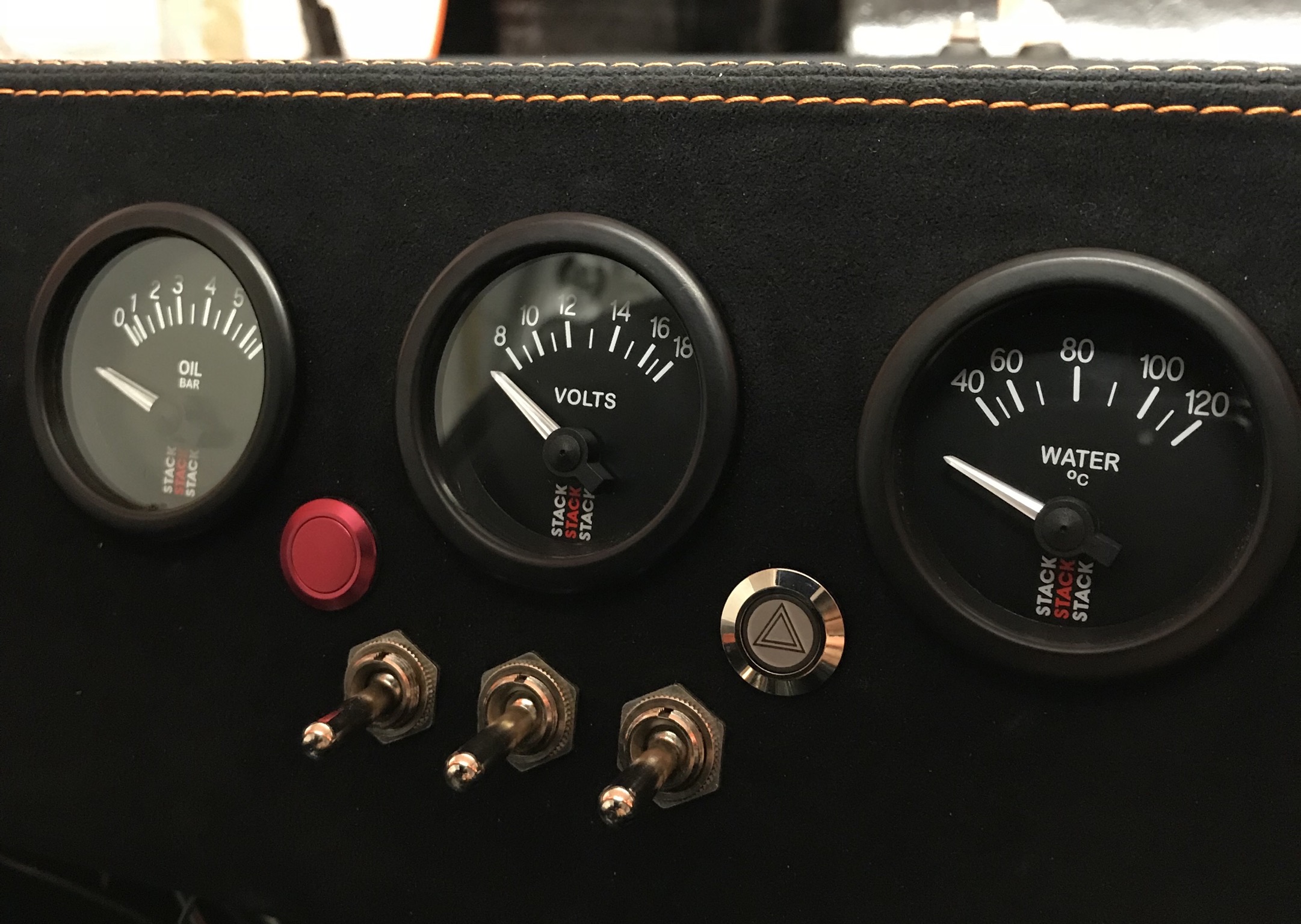

I’ve been overlooking the car build prior to the IVA in May and I’ve come up with a query...
I carefully measured and scribed an arc 127mm from the steering wheel and proceeded to locate my rocker switches between this line and the wheel. Once all interior was completed, whilst carrying out the alignment it came to light that the flat bottom type steering wheel when rotated effectively moves the rocker switches out of the exemption zone.
Am I up a creek without a paddle and need to fit a round steering wheel or would it pass?
(Flat bottom wheel helps the 6’2” driver actually get seated!)

I would beg borrow or steal a round wheel for the test. You can also fit toggle switch guards so the sphere of doom can’t touch the switches.

I thought as much, and deliberately avoided the guards as I don’t wish to puncture the alcantara as they’d be straight out after.

Why not replace the switches with button switches,
or fill the switch holes up, and locate the switches on a panel that is under the dash, and in the steering wheel radius
Also ALL switches need to be labelled for IVA, yours are not

I have individual labels that I’m fitting this weekend to comply.
Generally, not a fan of the aftermarket push button switches but I do like the idea of relocating them on a separate panel.

Just to clarify, I passed the test with the flat base wheel as the area only applies as per the M1 exemption diagram which is static.
For good measure I borrowed a round factory wheel just incase.
All rocker switch labels were placed on to vinyl strips, which post IVA peeled off without marking the alcantara. Happy days!
