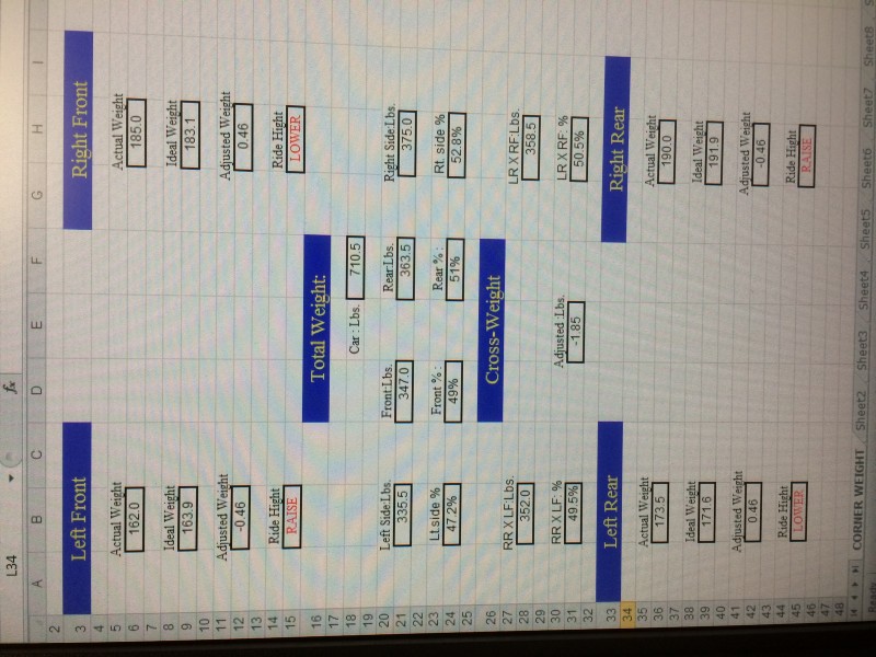

Postby Matth93 » Tue Apr 12, 2016 10:06 am
This is what my car was when I weighed it last year with me in it
