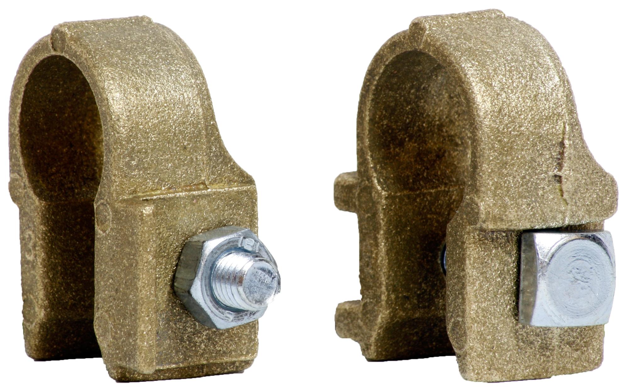

Apologies if this is bleeding obvious, but don't forget to check that the positive and negative terminals are the right way round. And the connection method is the same (usually round post, or screw through post).

Thanks all for the additional replies. On the terminals, I did check the pos/negative were the right way round. The actual terminals though.... good shout. Old battery is bolt through, and as all the pictures of the one I've order have caps over the terminals, I didn't realise. New one has posts. But, Halfrauds is my friend here, for a fiver
