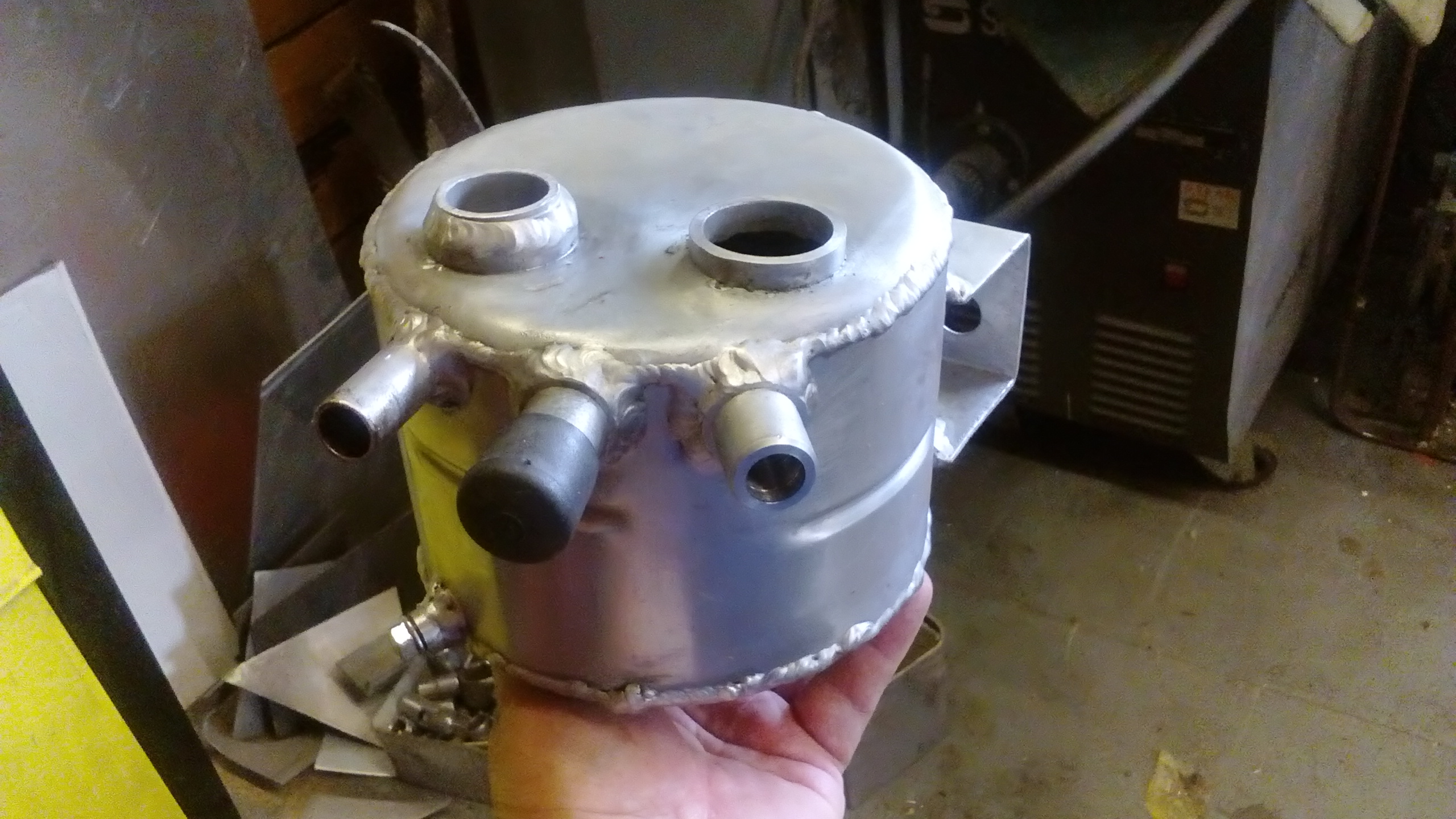

This is my old oil catch tank.and it gave me no trouble it had 2 filers on the top

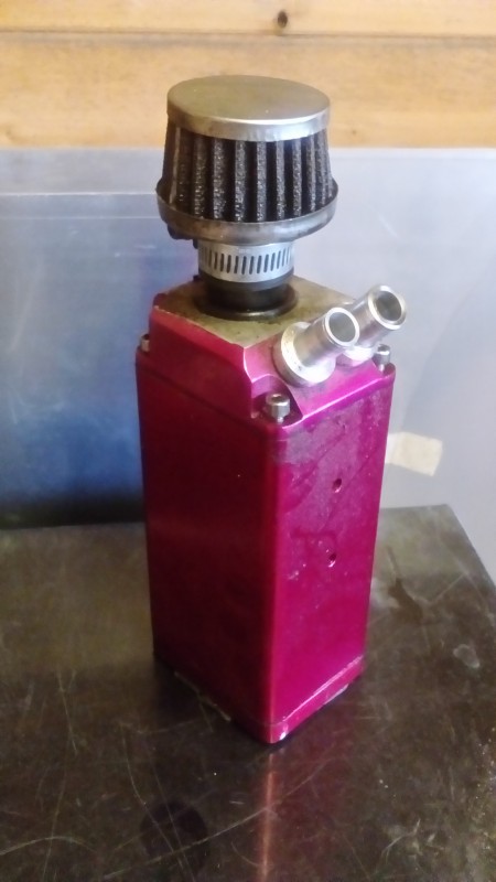

The new one has got 1 filter on the top. but all around it. is a fine layer of oil it is not catching any oil at all but on the old one it would catch about 20cc after about 500 miles
do you think the new new is not condensing properly this one has not got a filter but is the same

The catch tank in the seconded pic are not much better than scrap as the inlet is very high up and if you fit a filter its next to the inlet from the breather. Your old one had size on its side. The best ones are like the mocal ones with the vents on top and the breather pipes lower down. These work well but can be made to work even better with a cheap modification.

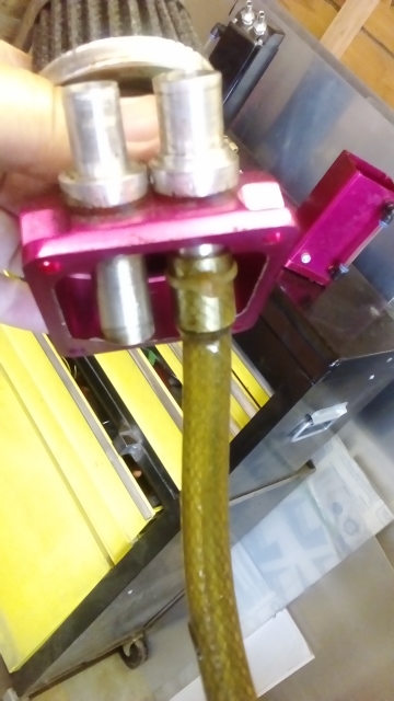

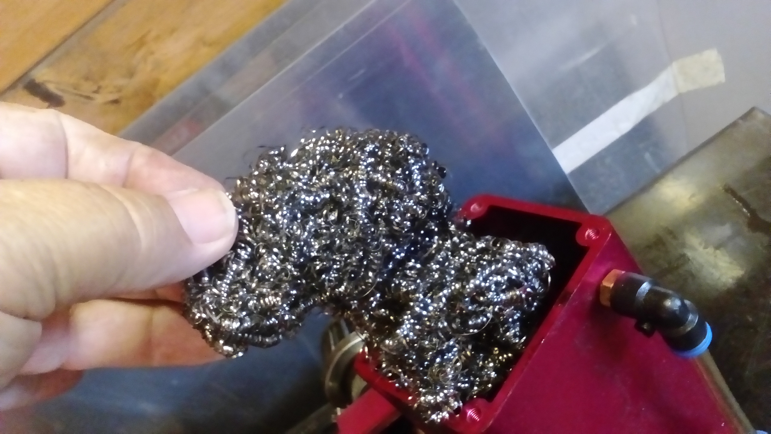

This is the filter.i have extended one side Eeemm don't no why only one so i extended the other one also the plate at the bottom was leaking which accounts for the oil.The stainless wire wool is a baffle
