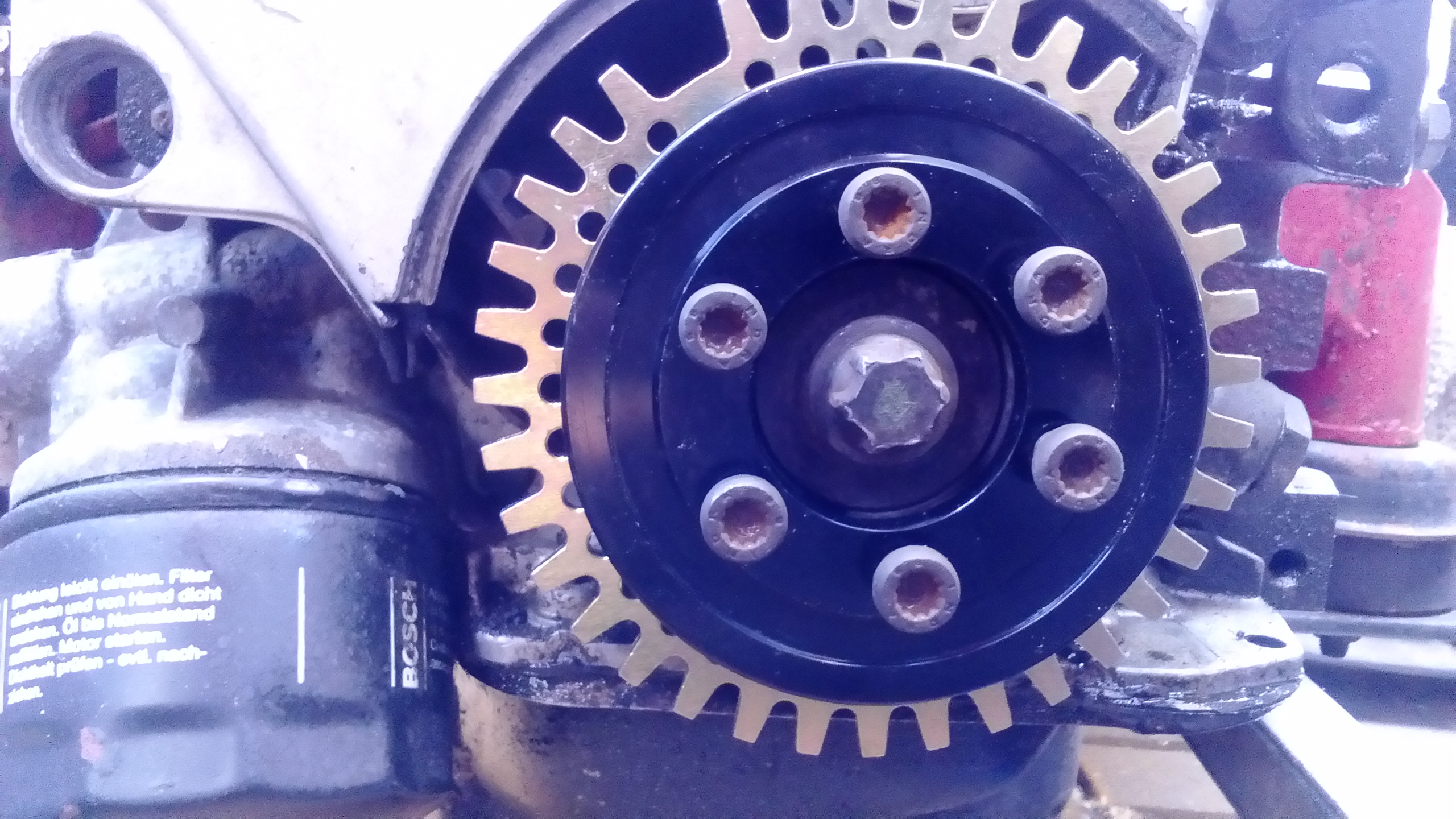

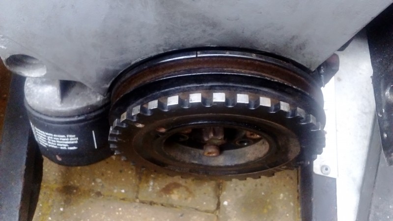

i'v been moaning about my car misfiring for some months and it was getting worse for some months so time to have a proper look.First check out the wiring i found the ground wire to the TPS was not connected one of the prongs had pushed out when the plug was pushed together instant improvement.I then noticed the trigger wheel was oserlating and one tooth out
The rubber damper was beginning to fail Dick did tell me it might happen

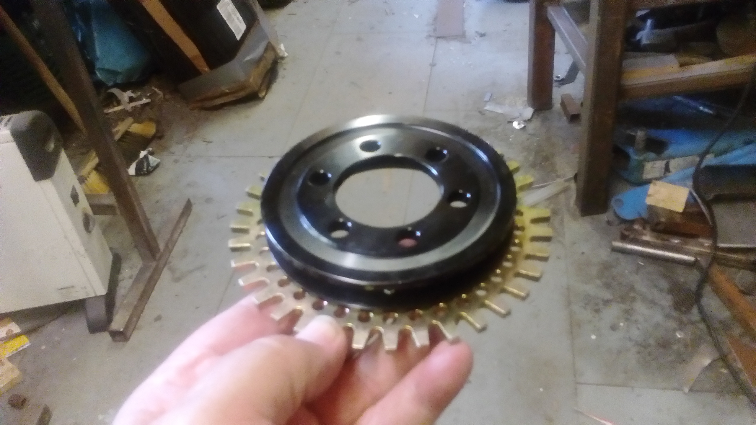

Fitted this it's perfect problem solved all i need is a proper map
the old one weighs over 3 pounds the new one weighs 11oz :o :D
