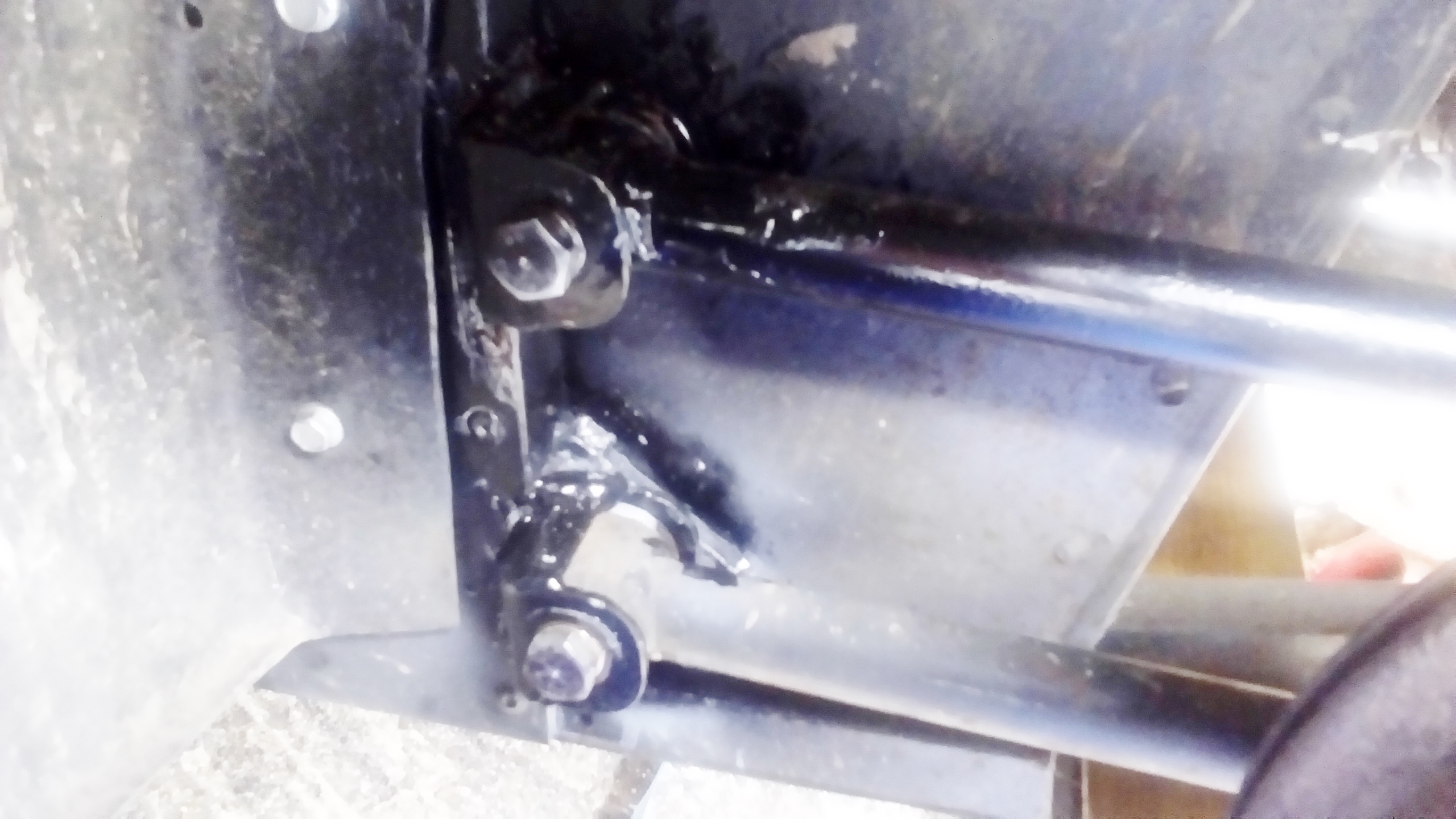

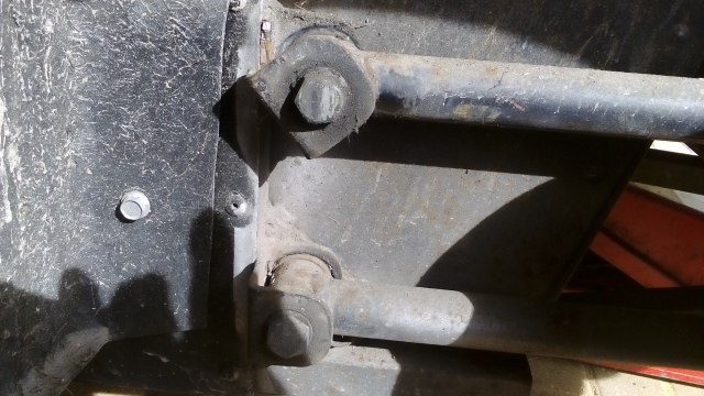

I was at the rolling read and when the car was running down the car was bobbin up and down a little discussion eerm might have lost a weight or one of the wheels or both are egg shape couldn't feel it on the read.this is what found
It looked a lot of work should have made the mod when i built it 10 years ago trouble is i believed the drawing what a dumy

Postby steve m » Sat Oct 08, 2016 9:01 pm
Tony,
I check mine every time I take the rear arches off, infact, that is one of this years winter checks

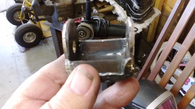

Postby Tony T » Sat Oct 08, 2016 10:39 pm
This is a new one it can't flex :D

Postby steve m » Sun Oct 09, 2016 9:09 pm
Rear drop link bracket on the chassis, not the rear axle
The book design is not very good,, and alas mine are exactly the same as Tony's except still attached to my car :D

Postby Tony T » Mon Oct 10, 2016 1:08 pm
Yup steve m has got it. Sorry hammy this pick might be clearer the paint job isn't the best but it's protected
I also did the bottom one because i found a crack.Got a top tip welding the ends together it is certainly going to pull in together so just do this it sounds silly but when you're welding it will always pull just have to think and do what it needs :)

Postby locost220 » Mon Oct 10, 2016 3:26 pm
I was Lucy enough to take 4'and half years building mine, giving enough time for a few repots to surface on locost builders of failures so moded mine by linking the outer edges of the top and bottom brackets together and caps on the ends. About time I checked them though.
