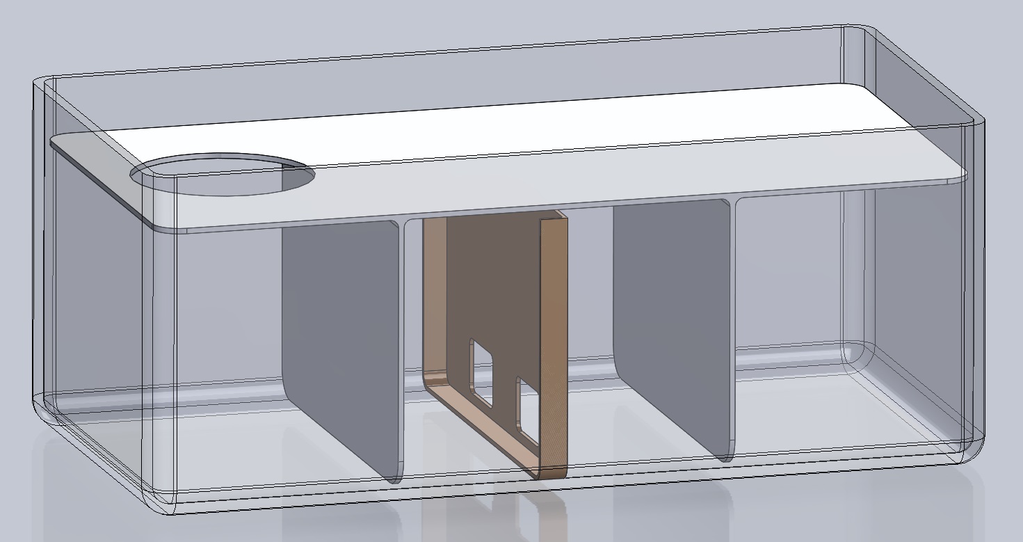

Thanks Dick, Mine's OK in most respects, but the oil light comes on (25psi switch) if I accelerate after the car's been sat pointing up-hill at a junction, the sump's baffled, but the pick-up sieve is at the front, so I'd like to modify it to put it in the middle. It shouldn't take long, but really too long to leave the engine's innards exposed.
Re: Spare Sump?
I have a plan, which will mean the sump's down for so little time I won't need a spare.
The sump currently looks like this:-
The sump body is shown transparent, & the "Pi" shaped bit is a baffle panel that bolts in from the top.
Obviously the strainer goes in through the large round hole.
Ideally I would move the strainer to the centre bay, but that relies on the new extended pipe being oil tight & at the moment the baffling is very nearly good enough, so why take the risks involved in taking the thing down & re-engineering a load of critical parts, when I only need a 10% improvement?
So, my plan is to make a new baffle in the centre, solid riveted to the sump pan with a couple of these http://www.forgemotorsport.co.uk/Viton_Oil_Control_Flaps--product--1235.html LUDICOUSLY EXPENSIVE flap valves in, like this:-
The new baffle would be sealed against the sump pan inside, so the oil can only flow towards the strainer.
As I see it, it can't be any worse. We'll see

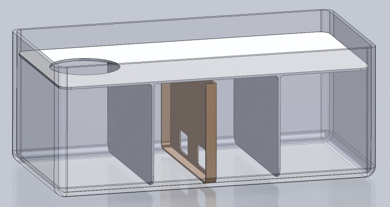

I have a similar set up on my car. The strainer is in the middle with a baffle containing a trap door at each end

Use a gated sump on the tiger mine are bits of metal with a bit of weight added to them its the old school way tried and tested over many years
Re: Spare Sump?
I did a google image search this morning & found some clever home made ones, made from door hinges with three of the screw holes welded up to make the flap. But I liked the idea of the Viton flaps, there's nothing to wear or stick. I'll do some more tinkering & see what I come up with.
