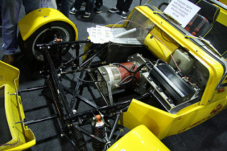

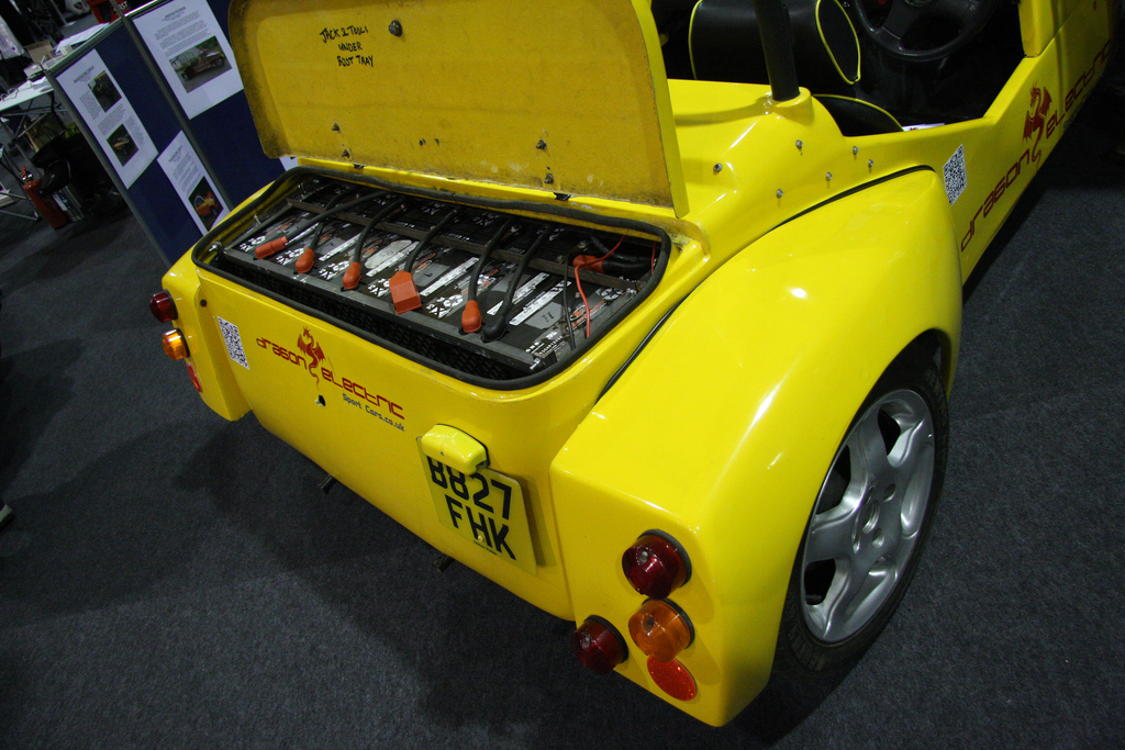

Re: Electric 7.....
Dragaon Electrics, did a Vindicator sprint already, but you might enjoy the person development touch.
Rich
Rich
- Attachments
- 6288883571_f3183ce5e9_n.jpg (43.92 KiB) Viewed 2123 times
- images.jpg (8.38 KiB) Viewed 2123 times
