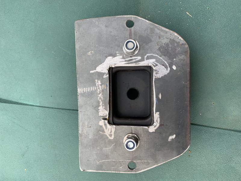

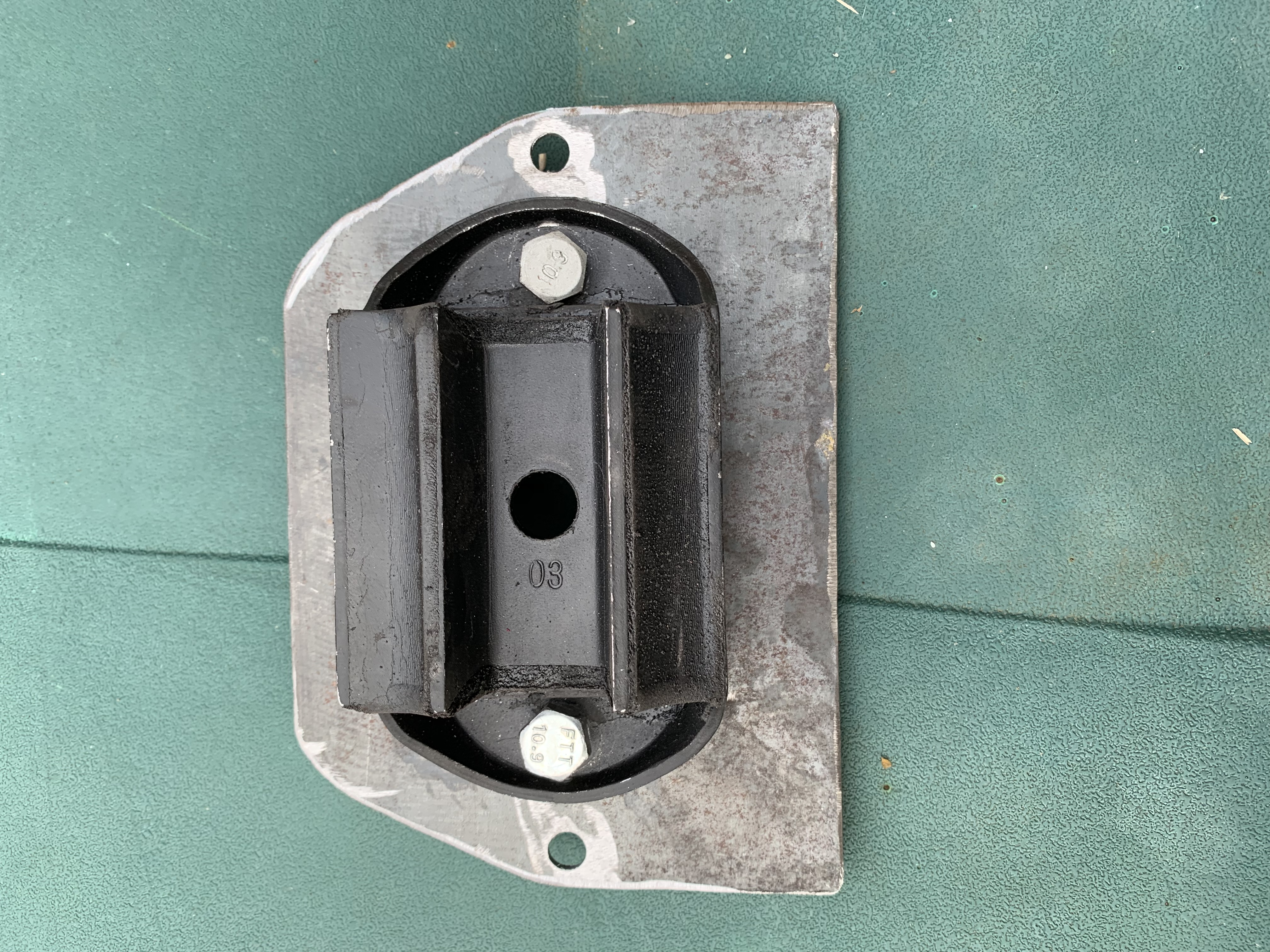

Postby Matth93 » Mon Oct 28, 2019 1:24 pm
I’ve got this type mount https://www.burtonpower.com/std-gearbox ... t9400.html
And it keeps breaking the bit that goes on the gearbox which then let’s it drop in the rubber.
I’ve just picked up this type from caterham as I was going past
https://www.burtonpower.com/gearbox-mou ... 2e400.html
Looks like it will fit the gearbox just need to make a plate to adapt the mount bolt holes down to the mount

Re: Gearbox mount
Postby DJ. » Mon Oct 28, 2019 5:02 pm
I have the second type, so far it has lasted 40000+ miles and it is under tension when all the bolts are tightened up too.

Postby Matth93 » Wed Oct 30, 2019 3:30 pm
So I’ve gone for the second one that I mentioned before. My theory on this is it’s the one that caterham seem to use and it looks stronger so should be ok. I’ve had to make up a plate to bolt it to, to make up the difference in size. It still needs a bit of trimming to size.

Re: Gearbox mount
Postby scotty » Sat Nov 02, 2019 9:49 am
i have the 2nd type it cured issues i had with the box moving on track days and things touching the gearbox tunnel.they are nice and stiff and were recommended as last for years
