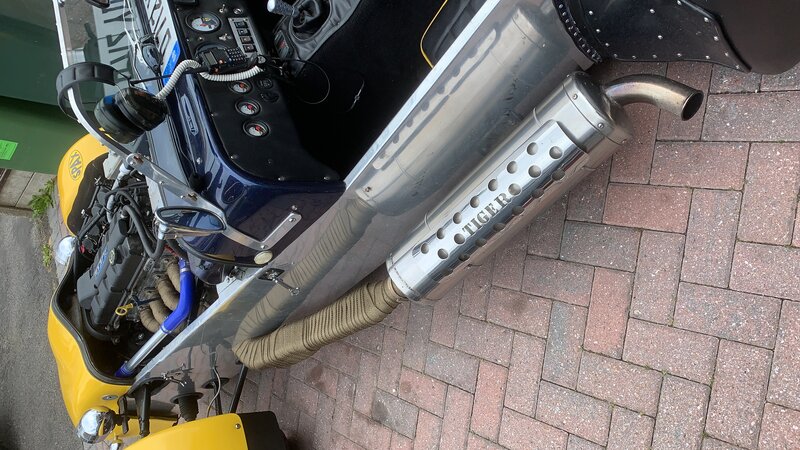

Took Car for a run after refitted exhaust.
The throttle was sticking.
Choke pull came away in my hand.
Loss of power, when accelerating.
Also found two leaks on bottom of rad.
Still got to sort
Checked carbs:- air leaks, silicone hoses, springs on throttle, refitted choke and shorten cable. Gave a quick spray of carb cleaner. All running ok ?? Strange

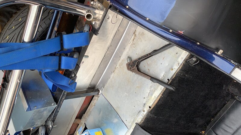

Little Jobs
Relocated the fuel pump lower down, as it was getting quite noisy, shorten fuel line, not sure if suck in air
Shin protectors :D from experience, still got the two burn holes
New exhaust wrap
Extra room behind seat by removing the Ply board
Only a couple of inches but will make a difference
Refitted net and edge strip in check plate
All packed away

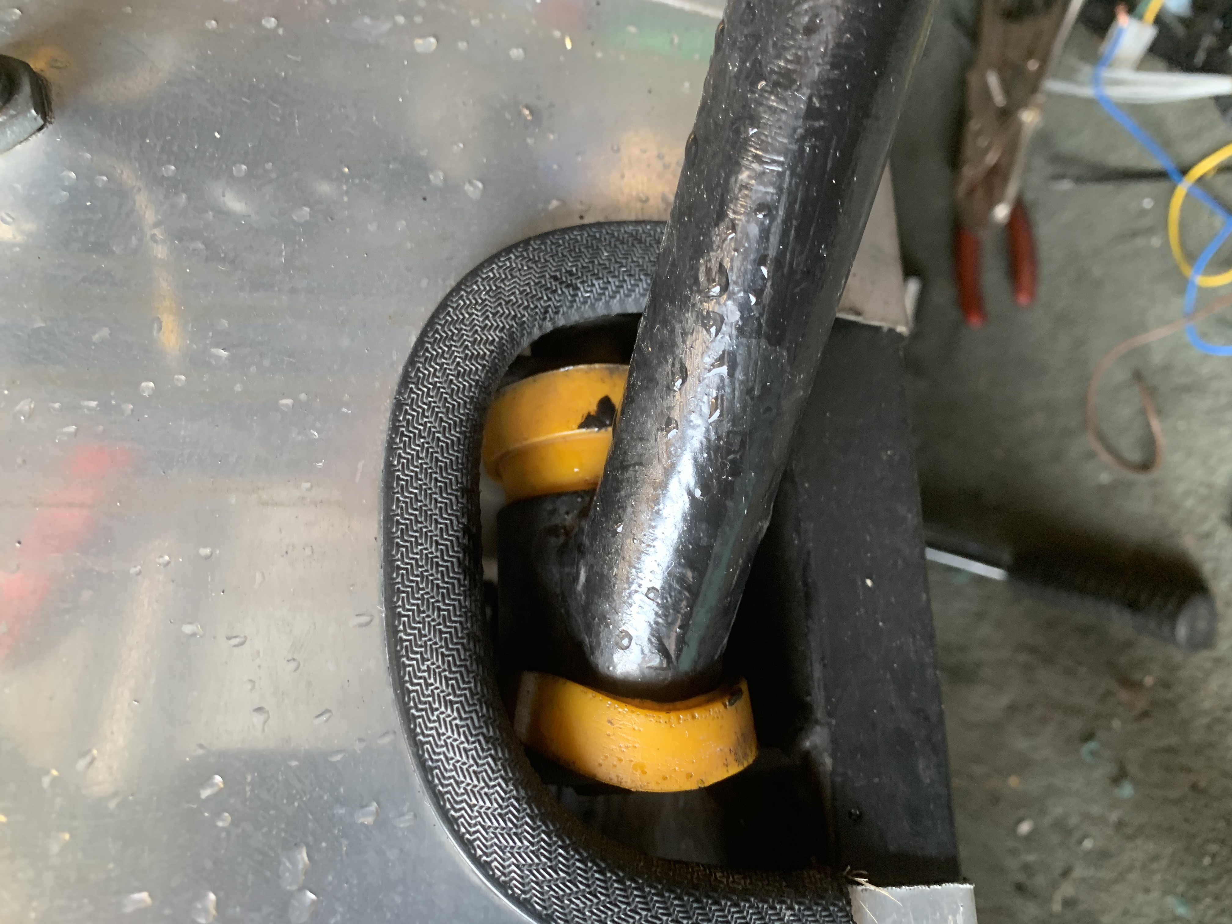

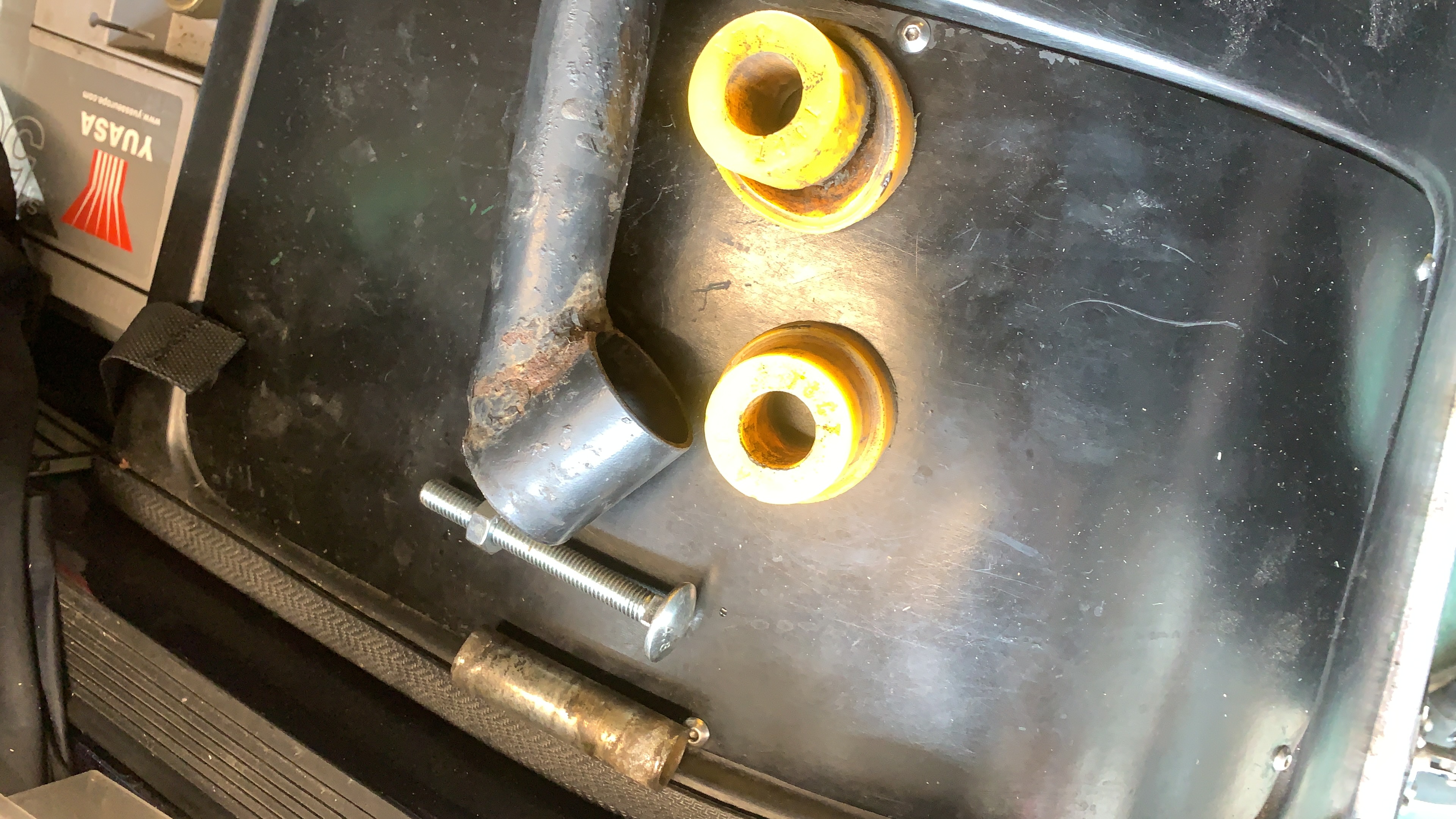

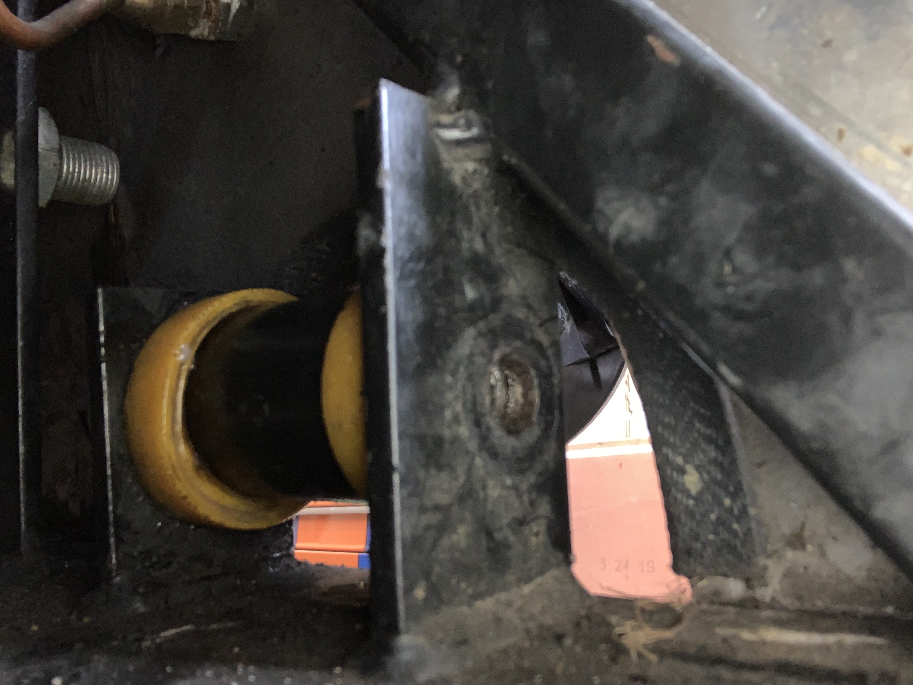

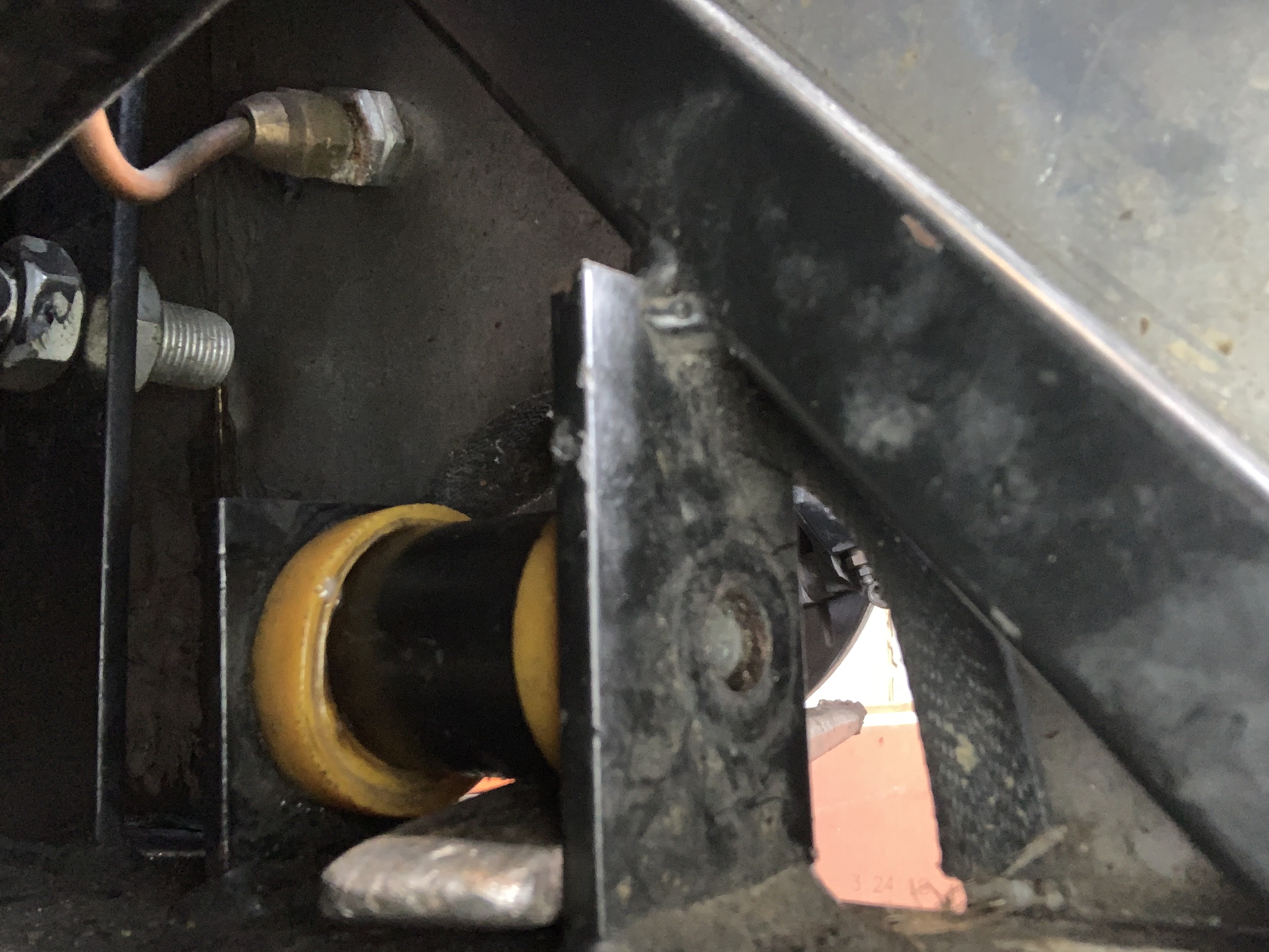

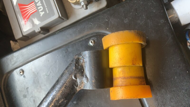

More trouble with the Tiger
Poly bush was split on the trail arm and the arm had move back, throwing out the Overall dimension, a whole 3cm out
Spoke to Tiger and they said haven’t got any in and waiting for delivery, which they didn’t know how long, they also said it wasn’t a standard Sierra part
Spoke to Burtons, they are only doing mail order so couldn’t go up to them and check sizes.
We decided to turn them around, so better one was at the rear of bush and split on front
Not having a good day struggling to line up
Need to replace but at the moment it’s refitted

Postby DJ. » Sun Jun 14, 2020 11:12 am
It should drive a lot better once you've replaced that bush!

Postby nelmo » Sun Jun 14, 2020 1:37 pm
Do you have to get them from Tiger? GBS sell them and I know they're still delivering as I got stuff of them last week. I'd imagine bushes are pretty standard size?
Re: Hedge 1 Tiger 0
Postby Kegco » Sun Jun 14, 2020 4:43 pm
nelmo wrote:Do you have to get them from Tiger? GBS sell them and I know they're still delivering as I got stuff of them last week. I'd imagine bushes are pretty standard size?
Yeah I don’t know as they don’t show the size
