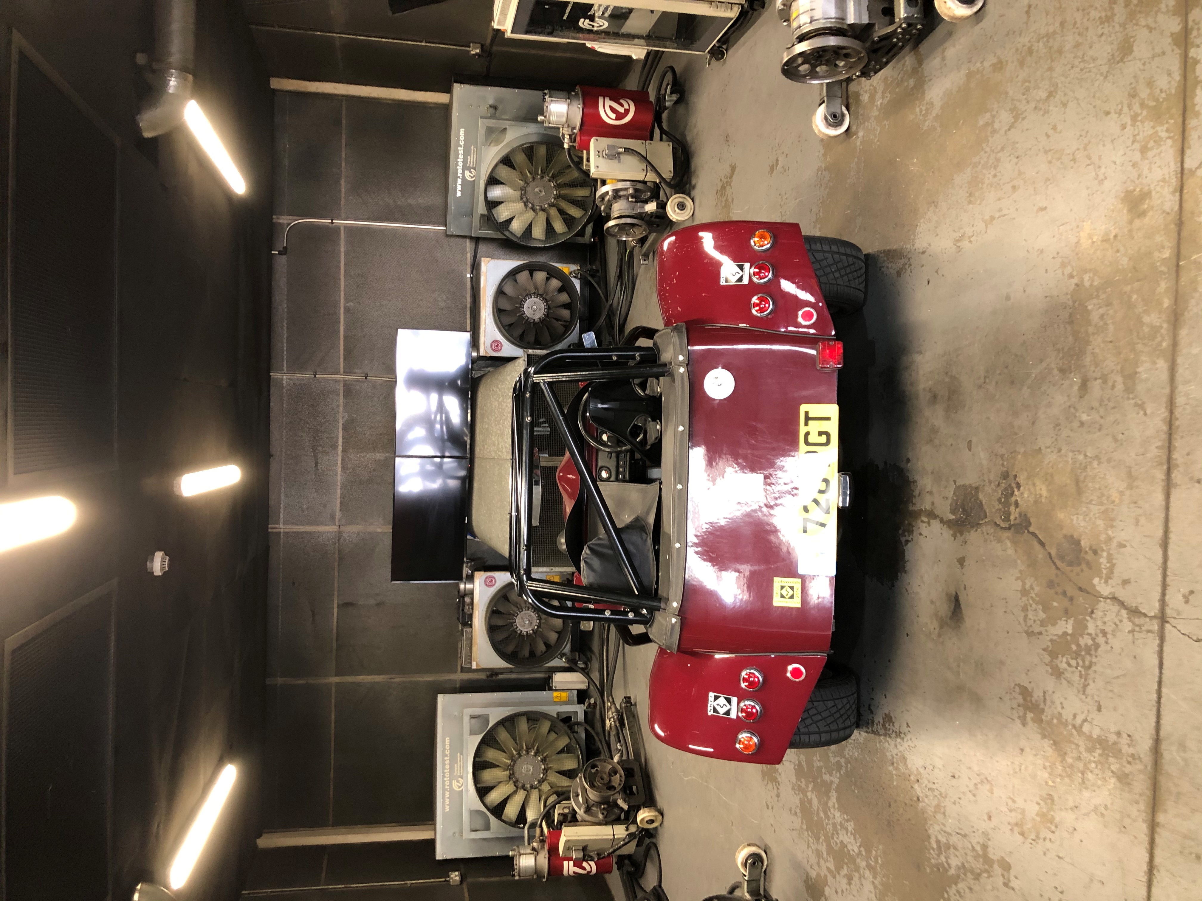

Part 3
Monday 19th April 2020, the day all this work came together in one very happy day for us all.
I woke up early, excited, worried but with a smile, I had never been to a RR session before so I didn’t know what to expect tbh.
The guy who was doing the tuning Jessie uses other Rolling roads around the area, he doesn't have a fixed place of his own but uses other peoples rolling road, but its got to be a certain spec. I left at 8 to make sure I was there nice and early, I was heading just around the corner to Ikea in Lakeside, I was there at 8.25, Dick and Jay were there already, after a nice chat Jess turned up.

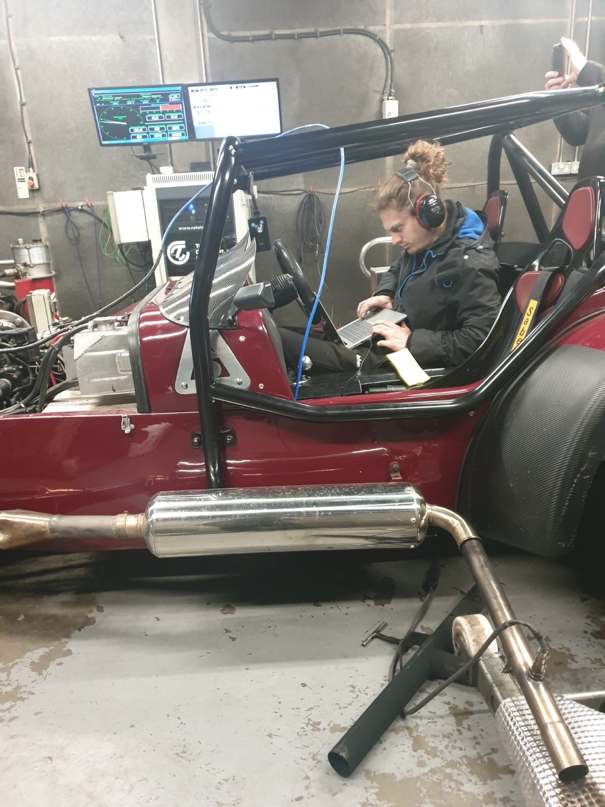

This particular RR is not one you drive on to, its not two rollers. So the first thing was to take the rear wheels off and bolt this machine which was on dollies direct to the wheels hubs, one each side of course. The next thing was to wire things up, at this point I must say that Jessie had already been down to Snodhurst, seen the car, made sure he could get in to it and read the data. There was a blue lead to see when it pinks, an extension exhaust was pushed up my original, this had a sensor on it for fuel.
Now we were locked in this room all 4 of us and its getting cold, due to 2 great big fans blowing at the front of the car, Jessie jumped in and did some checks, warmed the car up and double checked everything. Now you can imagine my horror when he set the rev limit to 8k flip really, this is a Zetec not a Vtec, I found out that that is were the RR starts from but he new how far to go, phew.
After a few runs where he took the car to 7k which was scary Dick reassured me it was fine, ARP bolts had been fitted all was good.

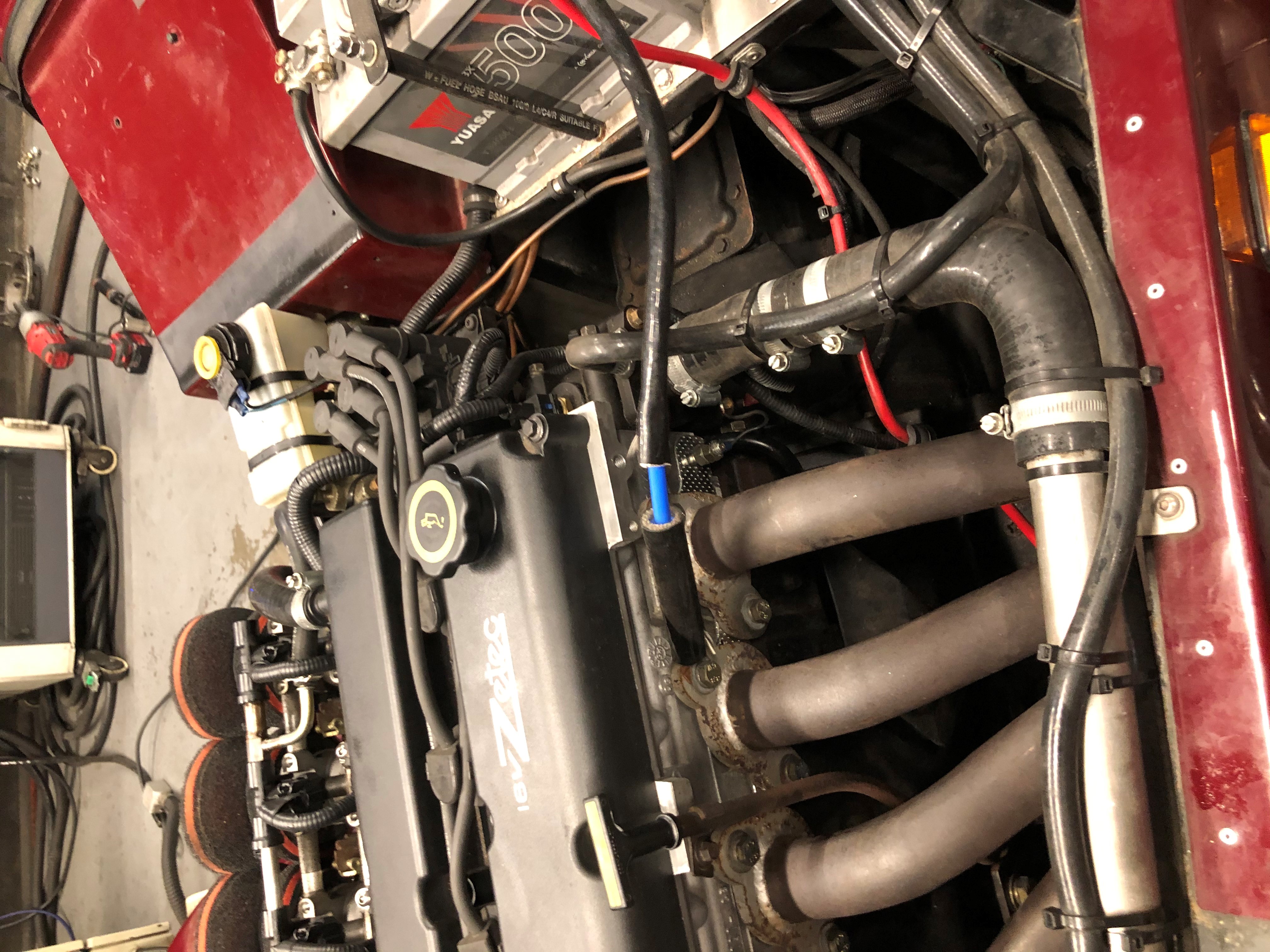

Have a good look at the filters and how they are trying to be sucked in to the trumpets.
https://www.youtube.com/watch?v=oKgSJQB4b4M
After a few runs where each time the car was taken to 7K but you could here it running smoother every time he did something but he was a little surprised with the figures we were getting, so a conversation with Dick we took the air filters off, now I had used decent quality filters Pipercross, I used the sock version one on each, I kept them clean and oiled.
Ok so what happened next was something that perhaps we could all look at, Jessie took the car again through the rev range to 7K but OMG the difference was immense 30BHP running no filters, Jessie had to make some other alterations due to now finding this extra power, but not just the power the torque curve moved as well, everyone was very happy, Dick new it would make good power and it bloody does.
The note has changed with out the filters.
https://www.youtube.com/watch?v=puSsr5Jj8Rw
I know people are going to say you must run some sort of filter and I agree so I am working on something at the moment, but how many times has someone had an engine problem because of no filter? Plus its hard to see how something can get to the trumpets from where they sit under the bonnet.
