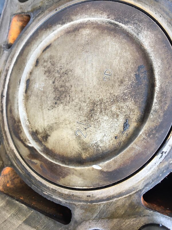

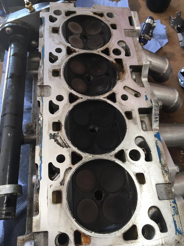

So today I cleared my diary and decided to pull the head off.

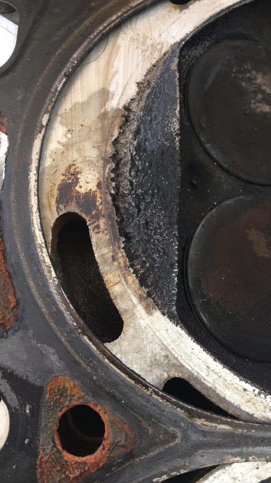

Strange I was really pleased to see a clear leak mark on cylinder 3 so now I know what the problem was.
Now when I was at the rolling road a couple of weeks ago I was told that I had the wrong plugs in it and he replaced these with new "longer ones" and this should help with the overheating as the current ones have the electrode too high up in the head. Well I think he was wrong on that point and was very lucky that I dont have a hole in my pistons
Looking at the offending cyclinder there is quite a bit of material missing from the edge of the head and looks like its been worn away, I am a little concerned if it will ever seal properly at this point as there is not much material to seal against the gasket at this point.
Also spotted two small witness markes on each piston when the inlet valves are just toughing.. So after its been skimmed I need to find a thicker head gasket to prevent bendy valves.
