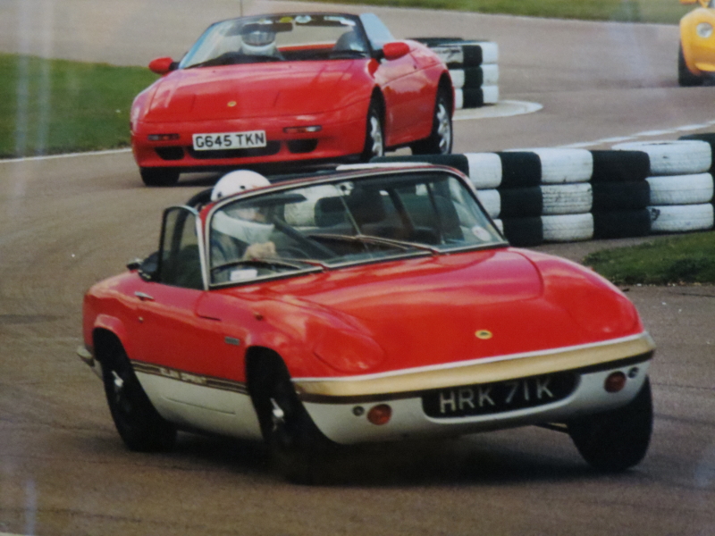

Hope you don't mind me adding a picture to this thread Tony :)
I've had another look at those photos and none of the casr exhibit the sort of roll I got with my Elan.
I've taken a photo of the framed print I have, so sorry for the poor quality:
