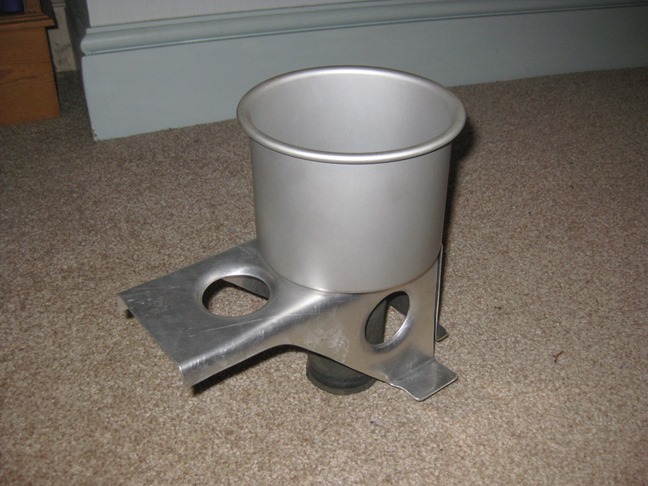

Yes, another of the problems I had to consider was that the filler is at the lowest point on the rear deck - go out in the rain & I wouldn't be able to refuel without a pint of rain going in the tank as the cap came off
Re: Fury Winter Upgrades
Right then here it is:-
Trial fitted in the car
With the bowl & filler attached
Obviously the bowl will be cut down to fit snugly under the boot lid, the hose needs shortening & it needs a rub with some scotchbright, but for two & a half hours work, I'm quite pleased
I'll put the whole story on the blog in case anyone's having trouble sleeping.

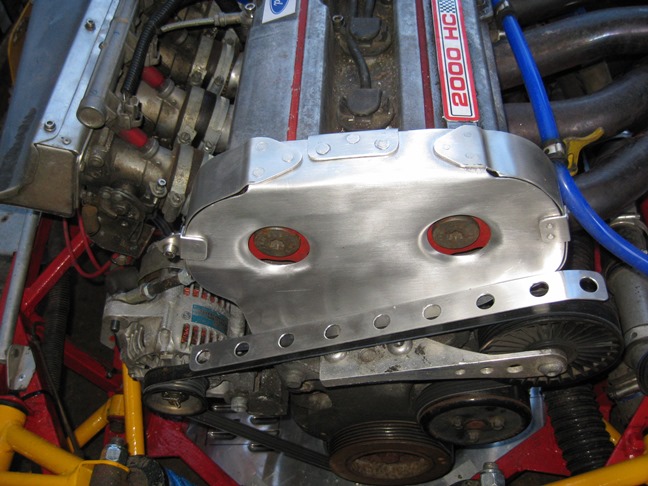

Cam belt cover's finished
