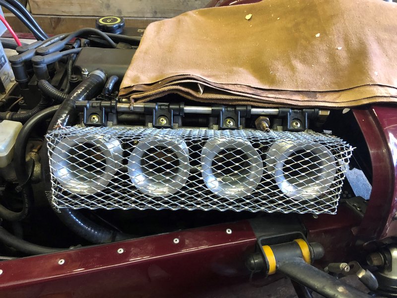

I can agree now Jeff but at the time it was a fix that needed to be done. I am now designing my own filter, the trumpets are hidden under the bonnet but I want to make sure they are safe.

You may have to cut the bonnet to make room for an airbox or bigger filters. As a temporary measure, maybe some metal mesh over the intake trumpets would at least stop large particles. It always surprises me how much dust collects under the bonnet of my Seven, so a filter is a good idea.

I am working on something as we speak Duncan, no need to cut the bonnet this should fit fine, just need to get a couple of welds done so Ill wait for Tony T for that. When its finished ill post a photo up.
DJ You may have to cut the bonnet to make room for an airbox or bigger filters. As a temporary measure, maybe some metal mesh over the intake trumpets would at least stop large particles. It always surprises me how much dust collects under the bonnet of my Seven, so a filter is a good idea.

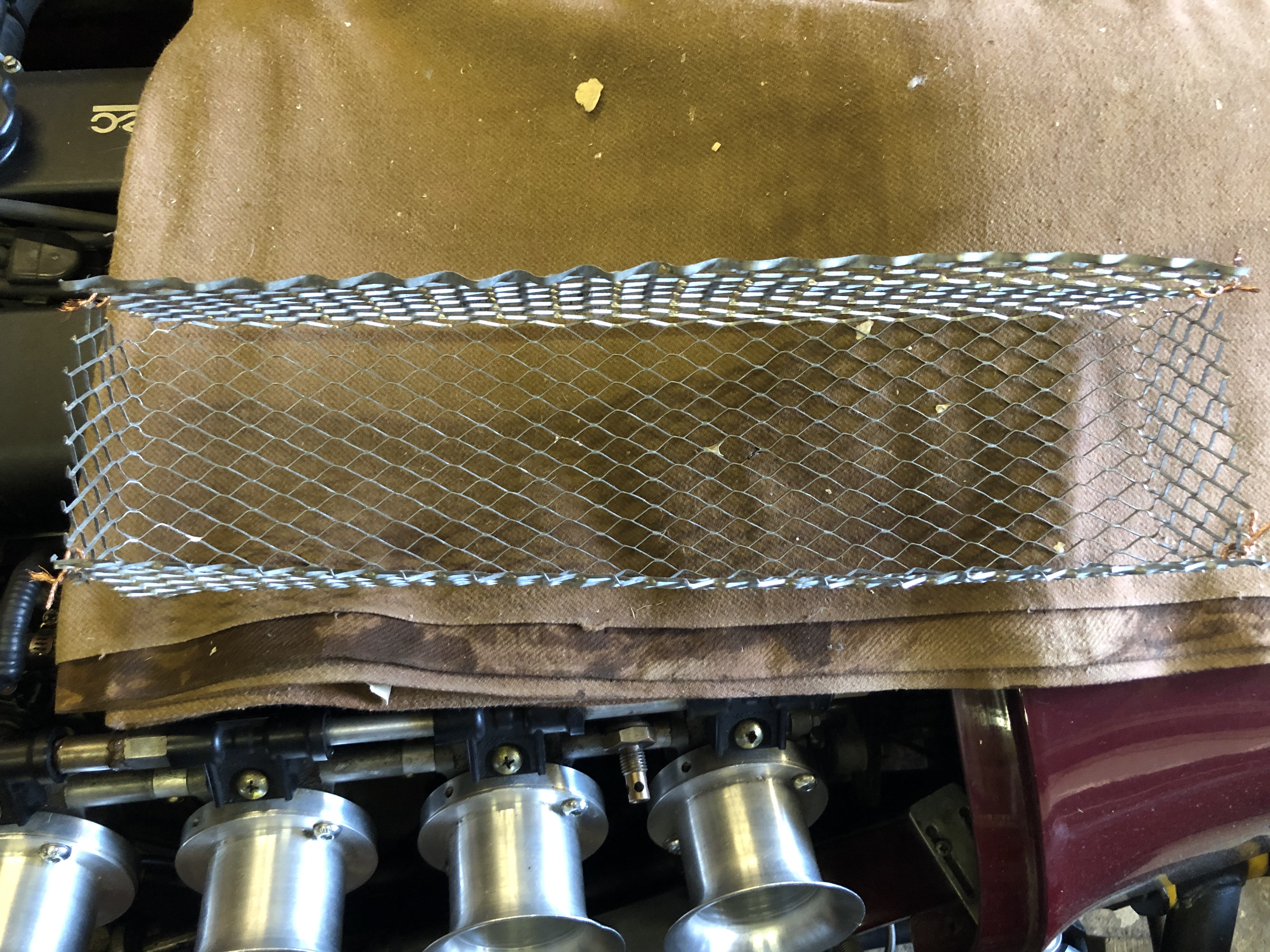

So Duncan was saying about air filter of some sorts, so I've done a couple but this seems to work the best. I just need to add some ali strips at the bottom going round the outer edge to give it a bit rigidity. If i have ali strips running on the outside edge and inside edge, i could then make a tab so it bolts to were the trumpets are bolted on, its not heavy so one top and one bottom. Once this is done i can layer more mesh across the top and half way down the side to make the holes smaller. The nice thing is this can't be seen while the bonnet is on so it doesn't have to be perfect, but just do a job.
Hopefully I've explained it well enough
You can see the outer edge, so this is were the ali will go around the edge inside and out.

I'd be wanting more than just wire mesh.
Just thinking of all the dirt and gravel that finds its way into all the nooks and crannies of my engine bay.
How about having a layer of mesh like you've done, then a layer of filter material, then another layer of mesh on top of that. That way the filter material can't be sucked into the engine and the mesh holds it all in place.
A bit like this, but with mesh on the outside too
Sheet of air filter material on eBay for £4 here: https://www.ebay.co.uk/itm/Universal-Air-Filter-Foam-Sheet-Make-Your-Own-Air-Filter-Reusable-RED/362060982416
