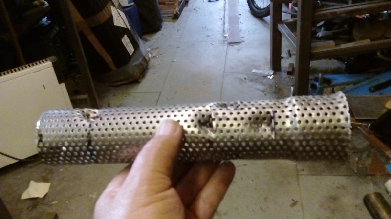

The reason for all the noise is in the photo half the glass has burned away and the reason for that is the stainless steel wire wool only covered half the perforated tube i bought this as a refill on a cardboard tube so wasn't packed properly so the SWW was working. But mind you none of the other packs i bought had any SWW in it.the perforated tube should have been welded to the end that comes off of the can you just can't pack it properly so i have got a solution when ebay deliver the rest of it

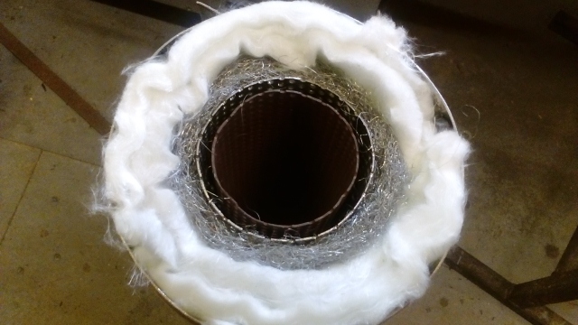

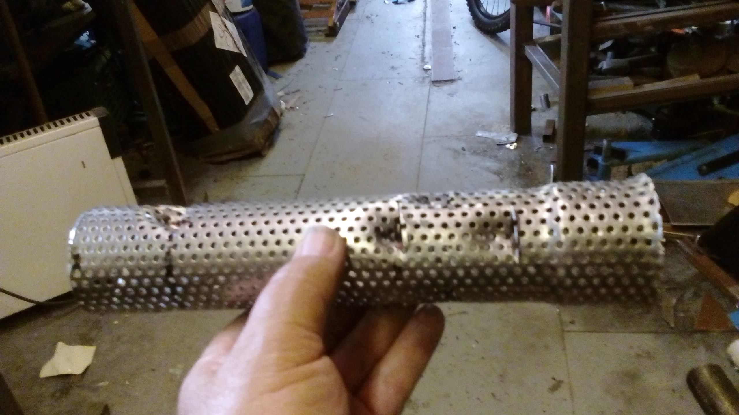

yup bits arrived this afternoon.this is what i'v done a piece of 3 inch x600mm perforated tube with some spacers prest in to it both ends to keep it tight and even all around i want a 6mm air gap.
DSC_0359 (640x360).jpg (223.81 KiB) Viewed 2269 times

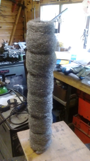

and then rap 2 layers of stainless steel wire wool around it.
then rap it in glass
DSC_0367 (640x360).jpg (180.65 KiB) Viewed 2269 times
DSC_0366 (360x640).jpg (188.33 KiB) Viewed 2269 times

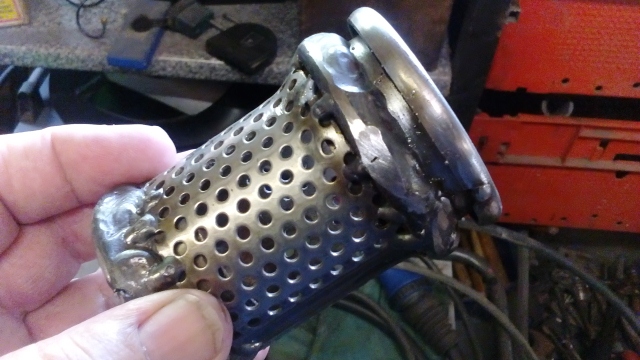

It's time to close now so ive made the stinger. I'd like it to be a bit longer but the bend in the pipe is just to much so it looks a bit industrial but it works
