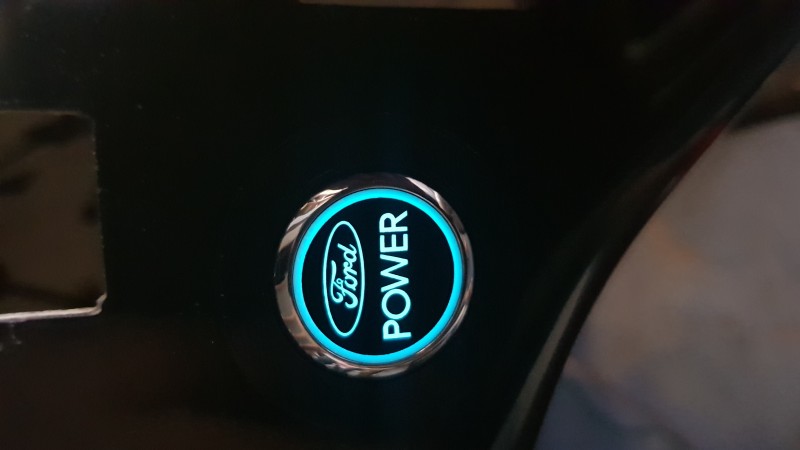

Also got side tracked fitting a starter button, requiring small circuit to drive relay and fabrication of 3D printed holder/bezel as Ford one was contoured to dash.

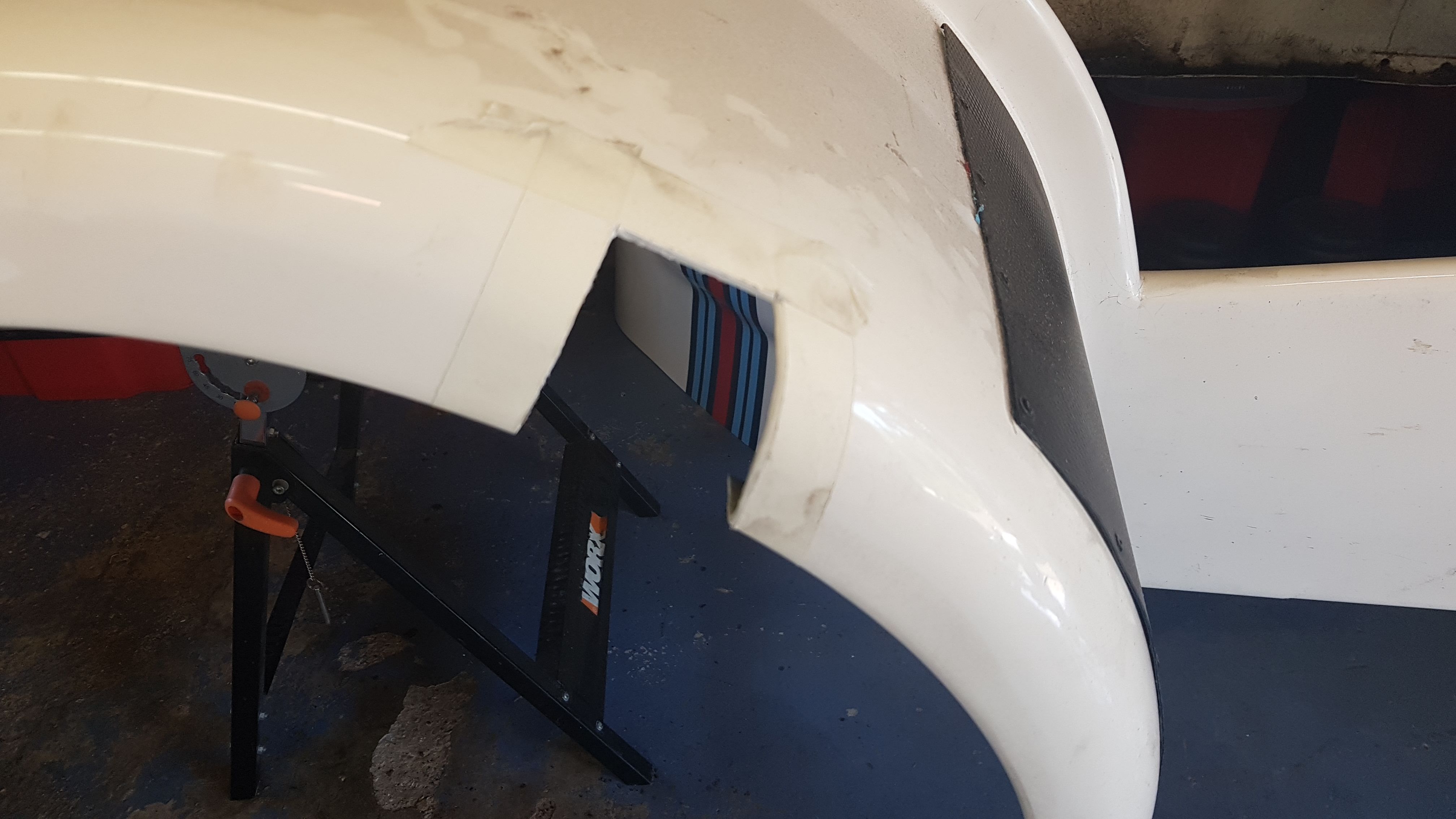

Gift pack delivered from East Coast Fibreglass Supplies (impressive next day service) and surgery begun :?

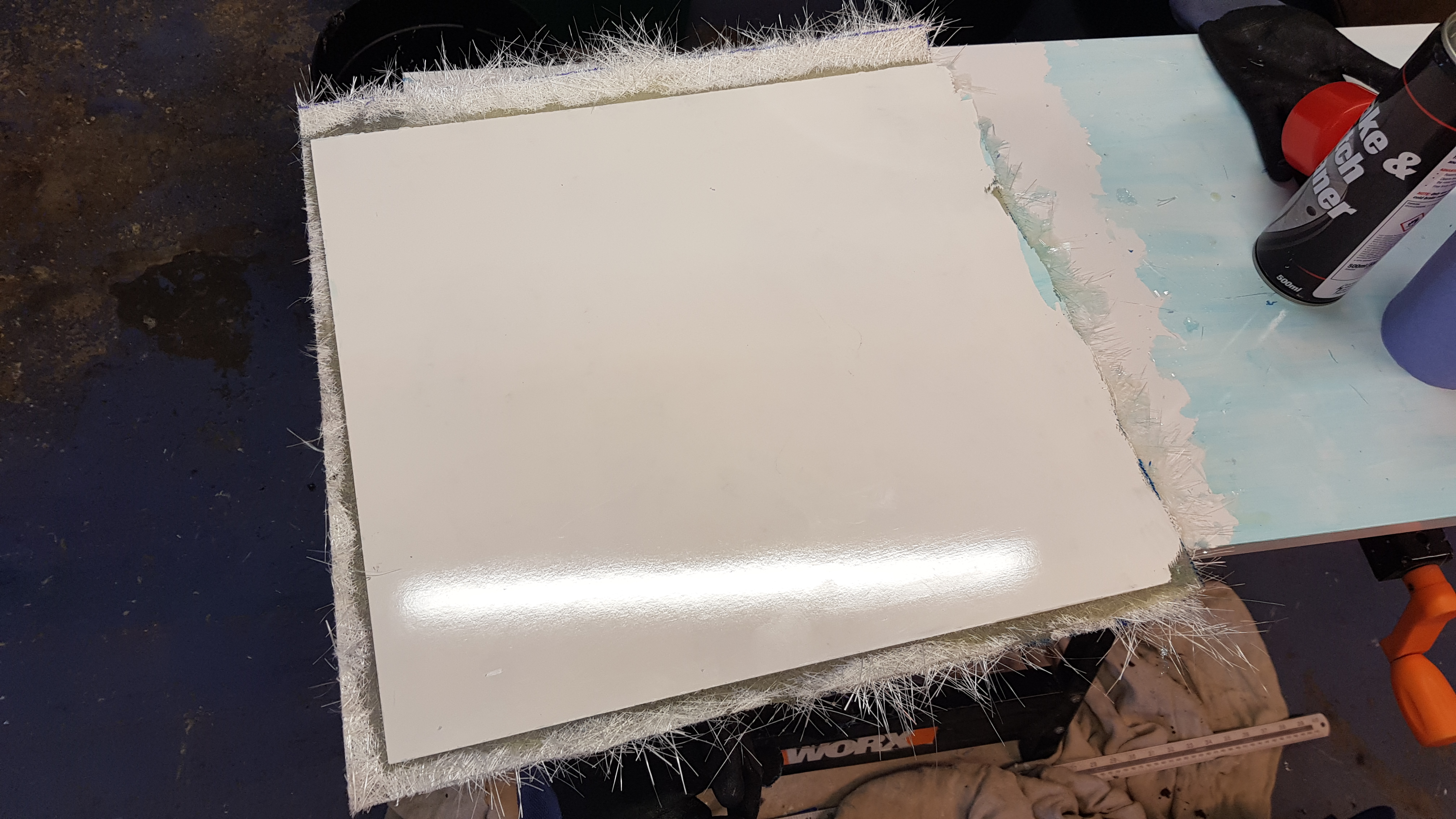

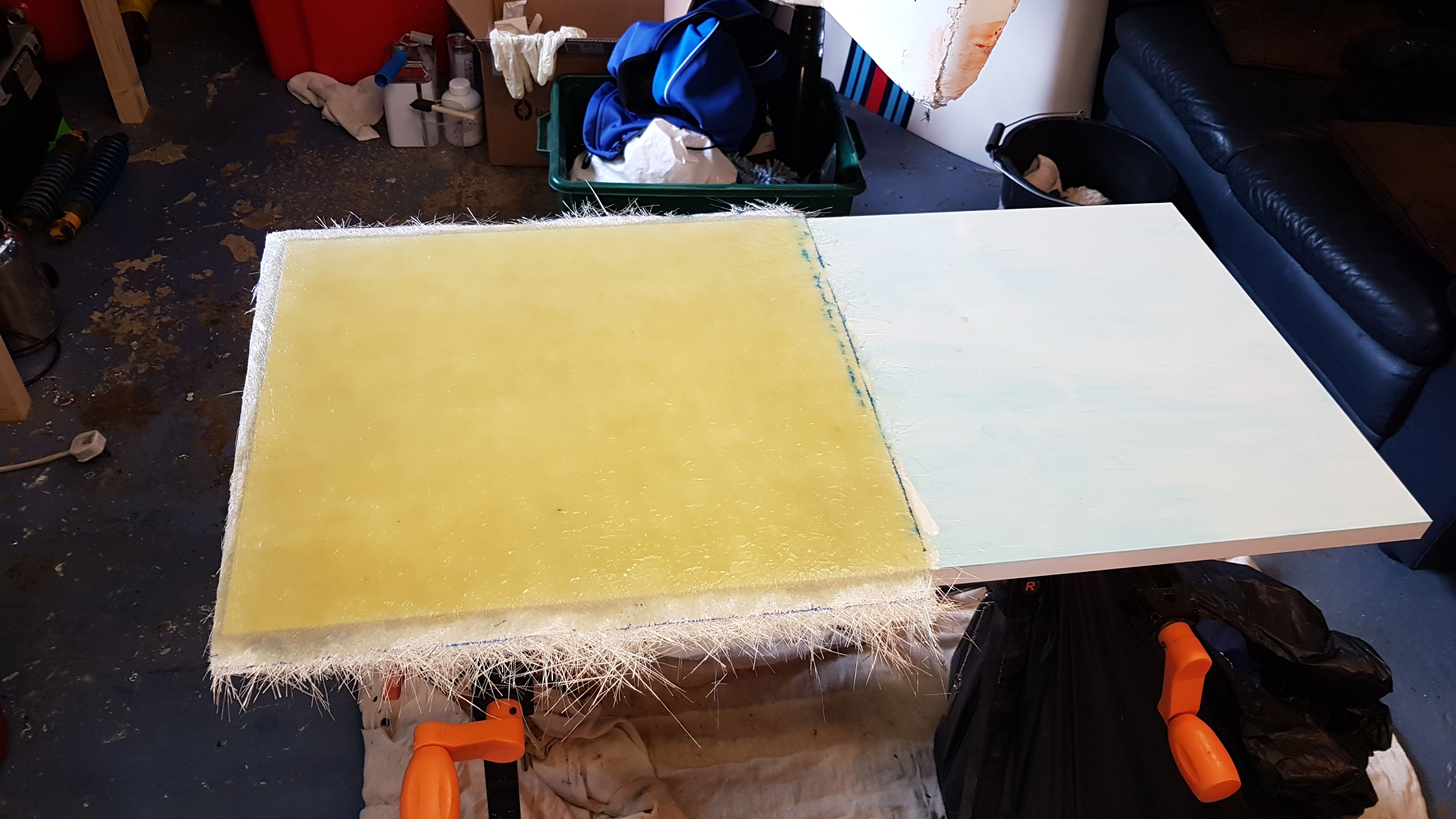

White gel coat 40cmx40cm test panel laid up. Will see in 24 hours what it's like.

The wiring sound like good work. I love the start switch :D I think you could sell them!

Crunchie Gears wrote:The wiring sound like good work. I love the start switch :D I think you could sell them!
Looking forward to the panel.
I'm just worried of Mrs Ts reaction when next goes to take the Fiesta out! :lol: :lol:

Postby Weathers » Mon Jul 02, 2018 4:14 pm
David T wrote:Gift pack delivered from East Coast Fibreglass Supplies (impressive next day service) and surgery begun :?
I’ve been really impressed by them, their speed of delivery and their customer service. Very helpful. Great company.

Postby David T » Mon Jul 02, 2018 5:47 pm
Well panel has come out not too bad for a first effort. Surface finish is very good.
