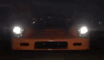

Got the new Evolution headlights in this evening...
A bit ‘Mulsanne flash’ with the LED driver units. 8-)

Postby Nash » Thu Apr 19, 2018 7:50 am
Love the flash to pass config on the lights Sam but be careful, I was advised that config doesn’t do much for the life of the LED’s?
Which hacked me off as who doesn’t want flash to pass!!!!

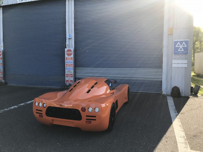

Postby barpilot » Wed May 16, 2018 10:15 pm
So yesterday the car passed it’s IVA. :D
A couple of issues on the early morning shakedown run; throttle cable end barrel worked loose and the alternator output post nut spun free causing an intermittent power cut to the EFI carb!
Drove the 40 miles there, speedo was mega keen (irratic 246mph) so had to make a stronger bracket at the station from the support vehicle supplies and tools I had loaded up. Fitted it and the test showed to be within 1mph of the roller calibration speed.
Noise limits were as close as you’d like to get! Phew!
Got the golden ticket and hope to send off the registration application tomorrow.
The return drive improved as the EFi has started to learn and adjust itself accordingly. Now to get the car properly finished for the road. Carbon fibre goodies soon.

Re: Ultima Build
Postby Crunchie Gears » Wed May 16, 2018 10:29 pm
Brilliant :D well done indeed.
