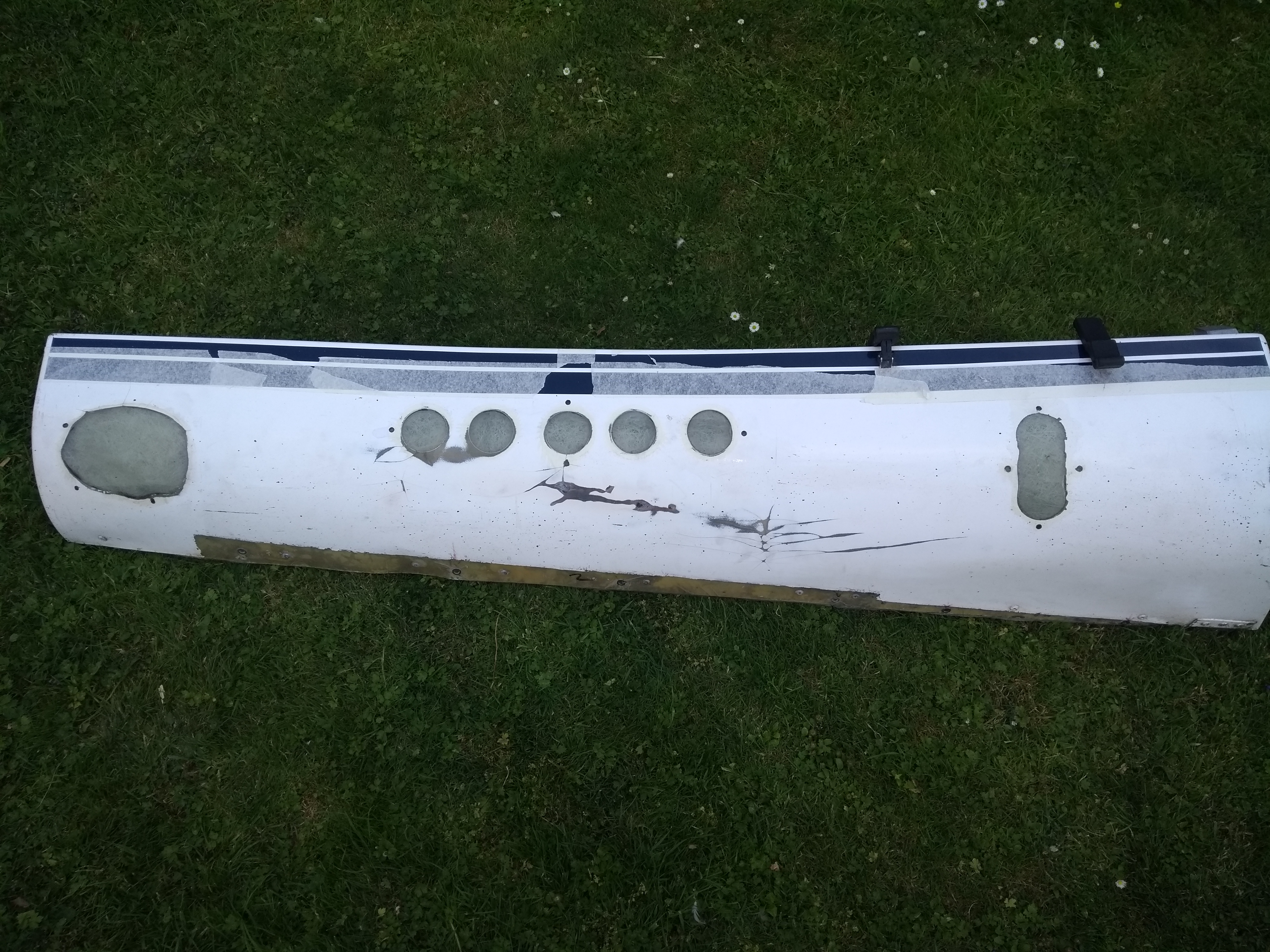

Standard white gel coat is not too far from my faded Tiger white.
Re: Buffing out the armco scuffs - sit rep
Postby David T » Mon Jul 02, 2018 5:51 pm
Looks like gel coat was not thick enough. There is some blue tints showing through top surface from blue lay up resin. When held to the light you can see why from underside. Might just have been a bit too hot for laying the gel coat. Garage is around 30 or more and wisdom says GRP work best at 15-20 degrees.

David T wrote:Might just have been a bit too hot for laying the gel coat. Garage is around 30 or more and wisdom says GRP work best at 15-20 degrees.
I had the opposite problem over the winter. The garage was constantly less than 10 degrees often 5! Had to buy what looks like a jet engine and crank that up. I did enjoy doing the glass work though. Keep up the good work!

Postby Tony C » Tue Jul 03, 2018 12:17 pm
Good job, looking at build pictures of mine there was no gel coat, don't envy you tackling that. My fibreglass patching drying in the garden, where the bonnet and side pods have lived for a few days now. If next time I'm out there's a hint of masking tape and greaseproof paper you'll know my DIY release agent didn't work :lol:

Postby Tony C » Tue Jul 03, 2018 5:11 pm
It only worked :o SWMBO best greaseproof paper with a card backing to follow the shape of the side pod, held in place with masking tape. A few places round the edge of the holes where I didn't use quite enough resin, nothing a bit of filler won't fix :D

Postby b33fy » Tue Jul 03, 2018 5:55 pm
Nice work both. My attempts were not as sophisticated. Old cereal boxes cut up and taped to body part then layed up with resin and mat. Pulled off some card once gone off, removed rest with power file then skimmed with filler.
