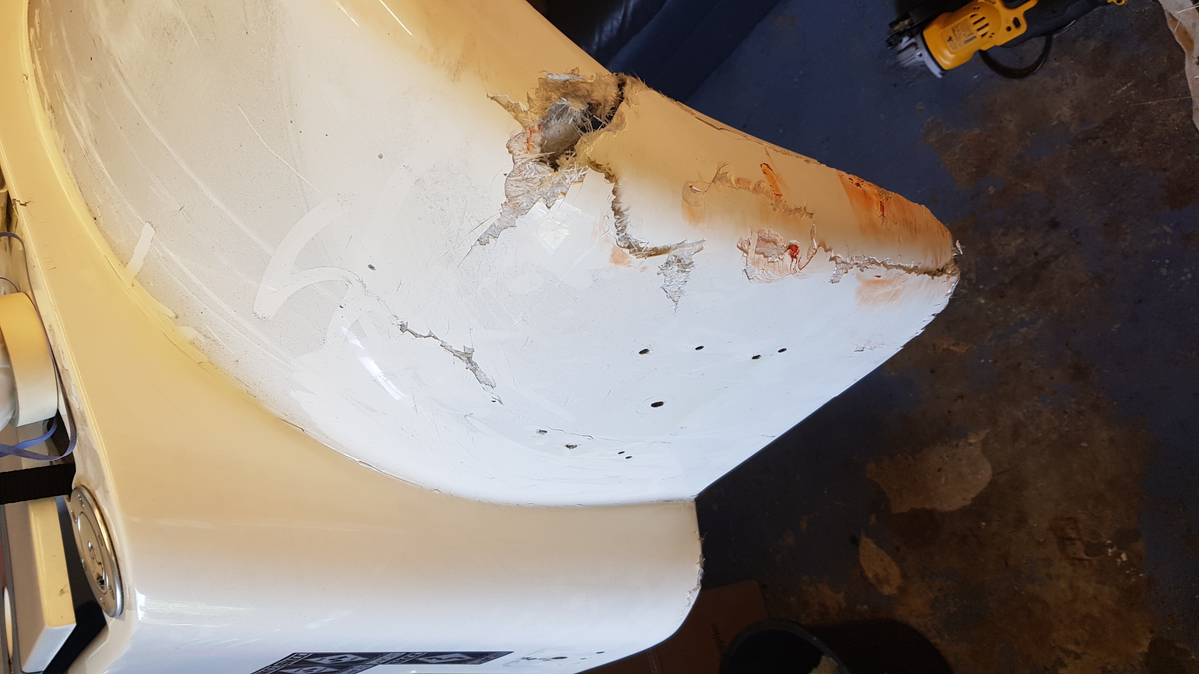

Postby David T » Sat Jul 21, 2018 9:50 am

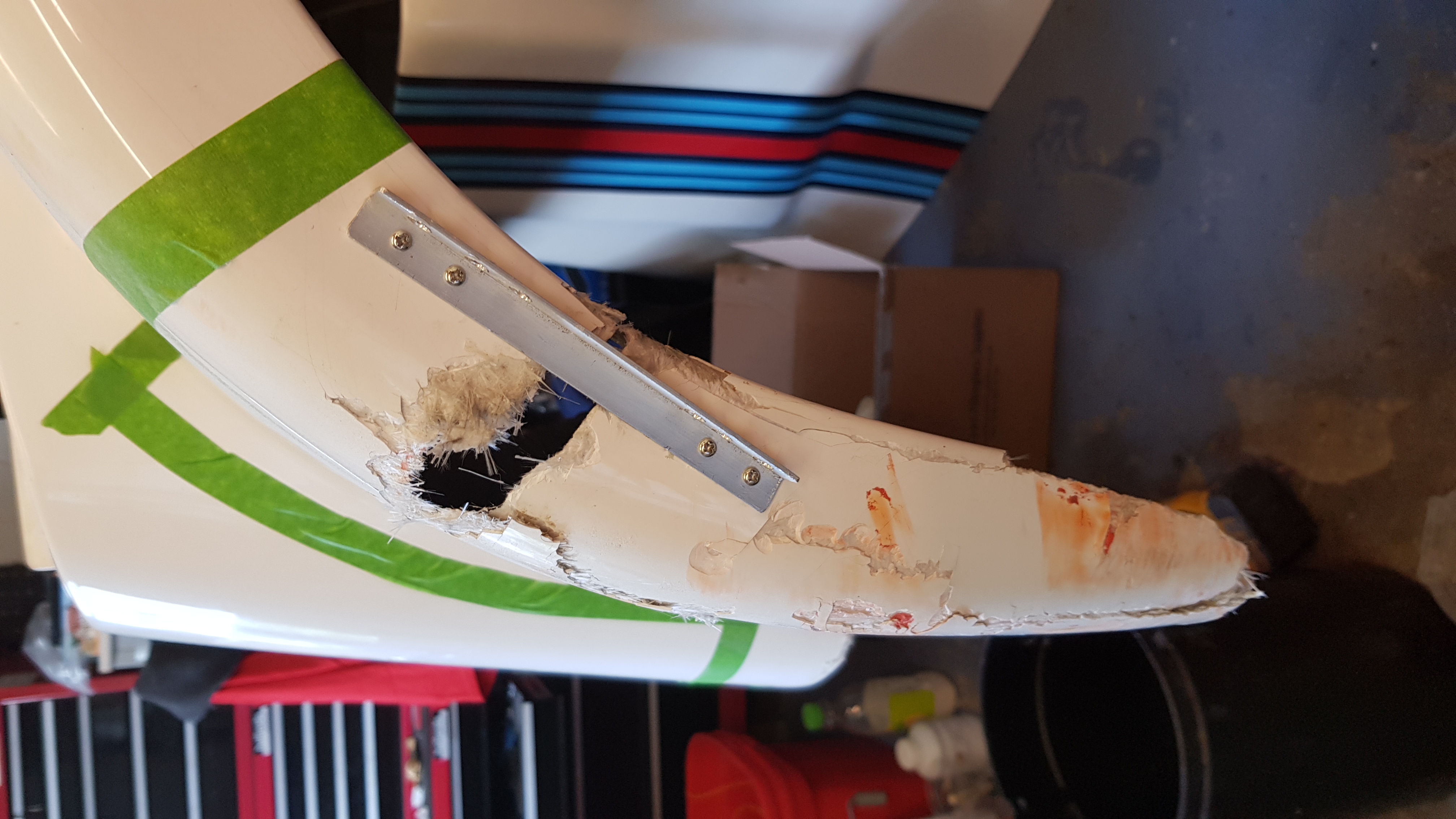

Rear arch before repair.
Red is the paint that rubbed off the Barrier!

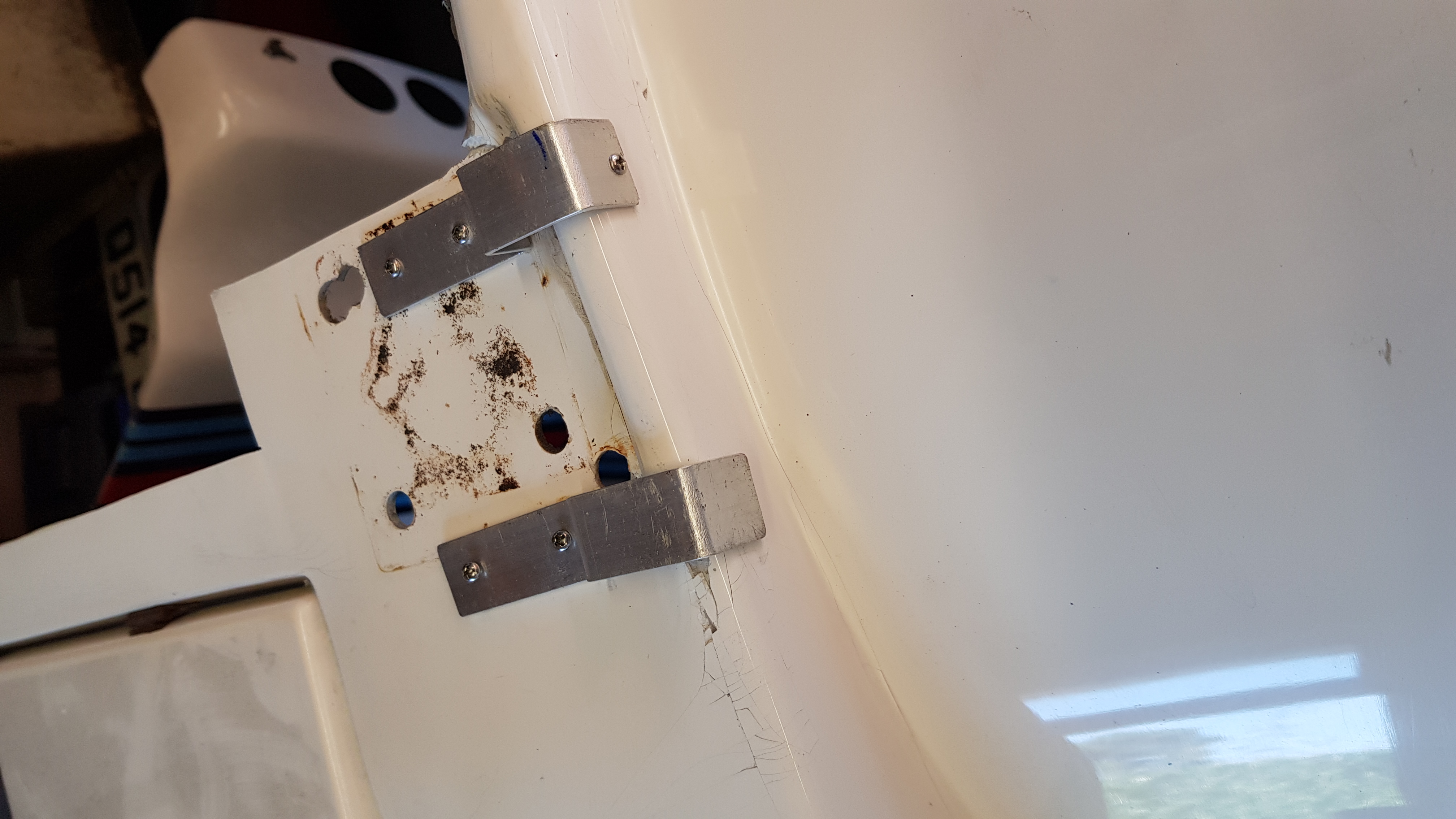

Postby David T » Sat Jul 21, 2018 9:52 am
Roughly reconstructed with makeshift brackets and self tapping screws.

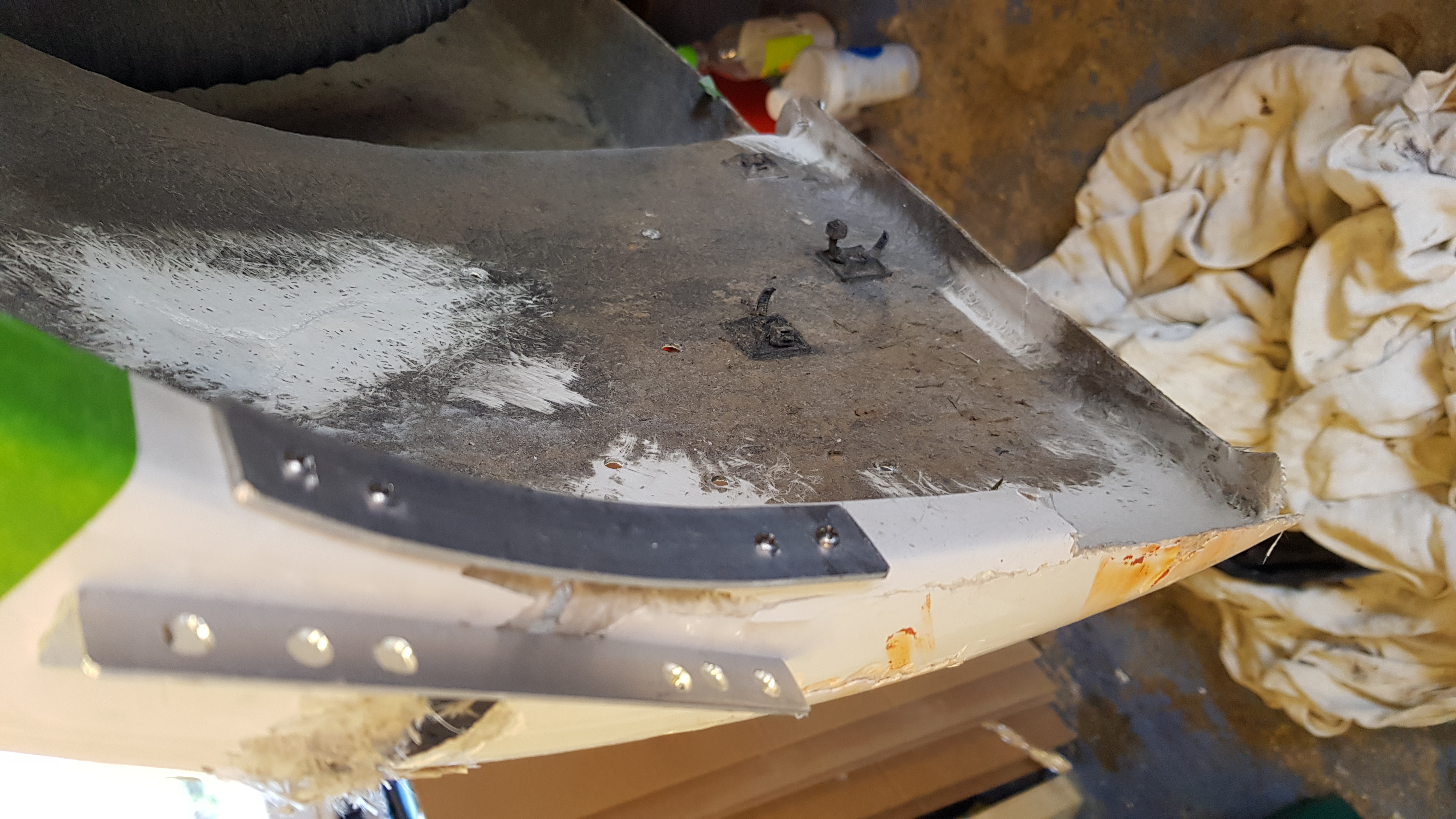

Postby David T » Sat Jul 21, 2018 9:54 am

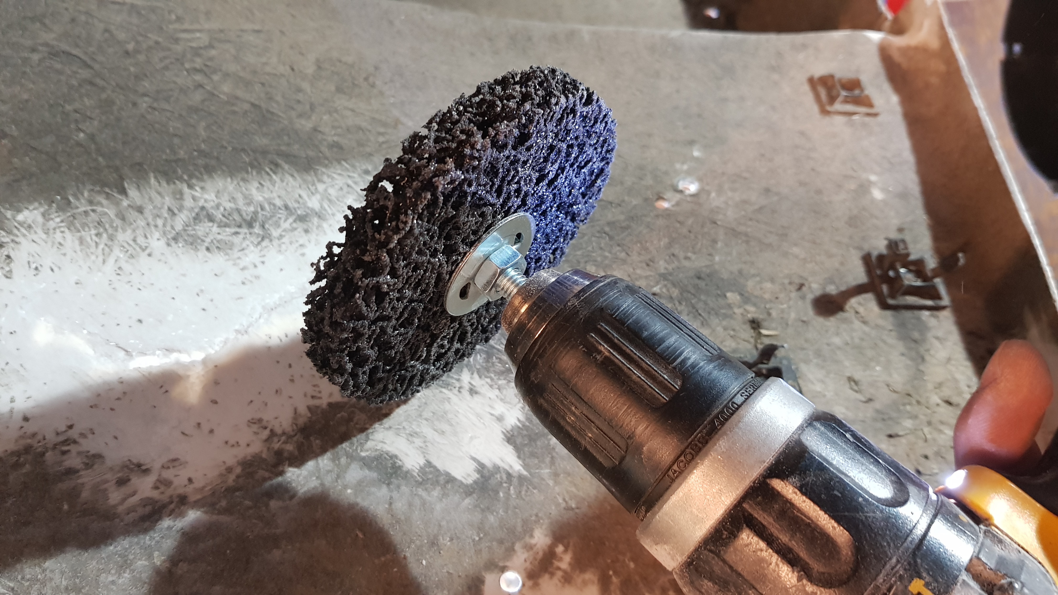

Back surfaces keyed with Screwfix paint removal tool that was so effective on chassis. Wire knot wheel was useless as it just polished the high spots.
After this some GRP was laid up on the rear and then the brackets could be removed.

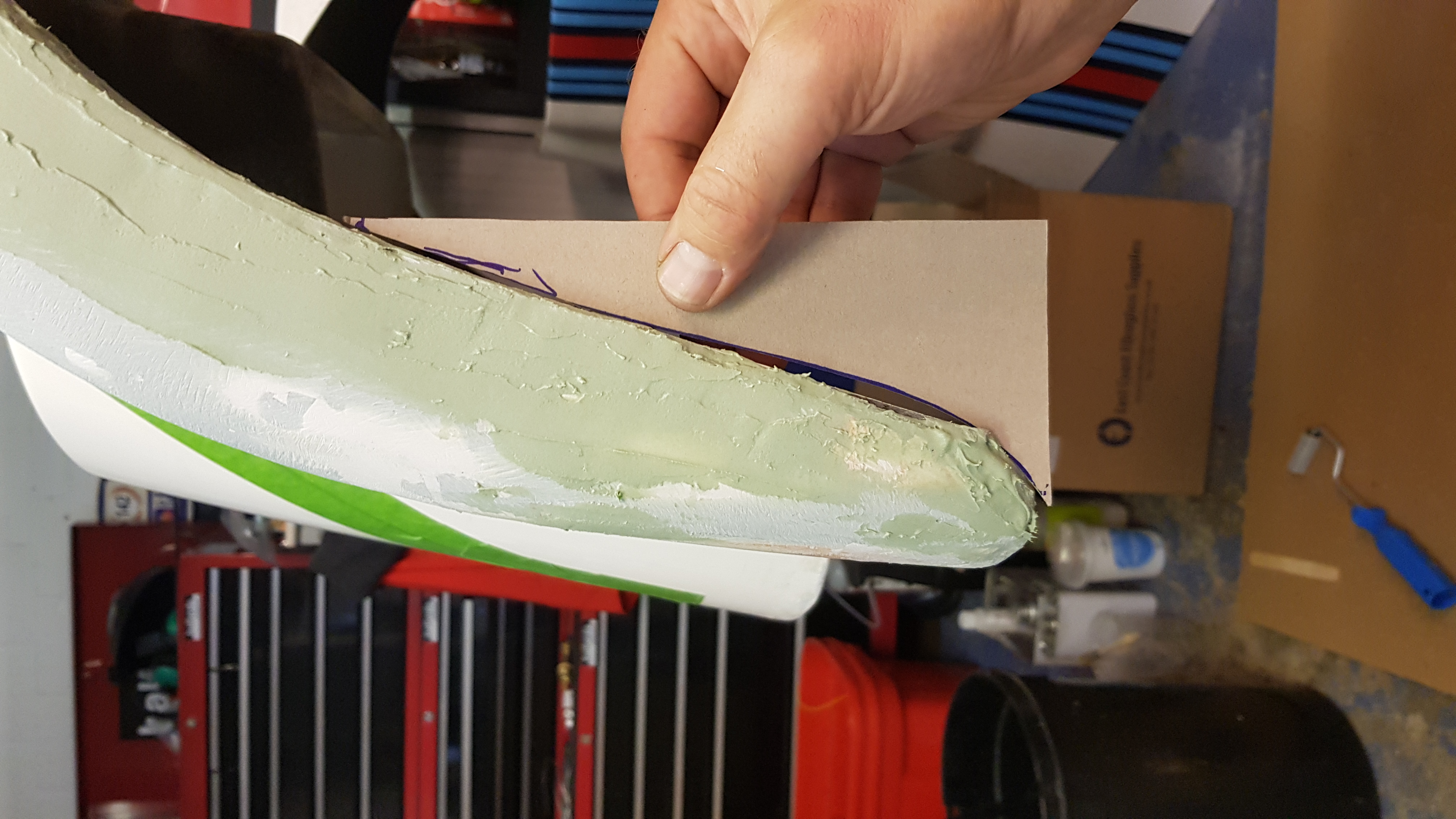

Postby David T » Sat Jul 21, 2018 9:59 am
CAD template used to copy shape from good side of car.

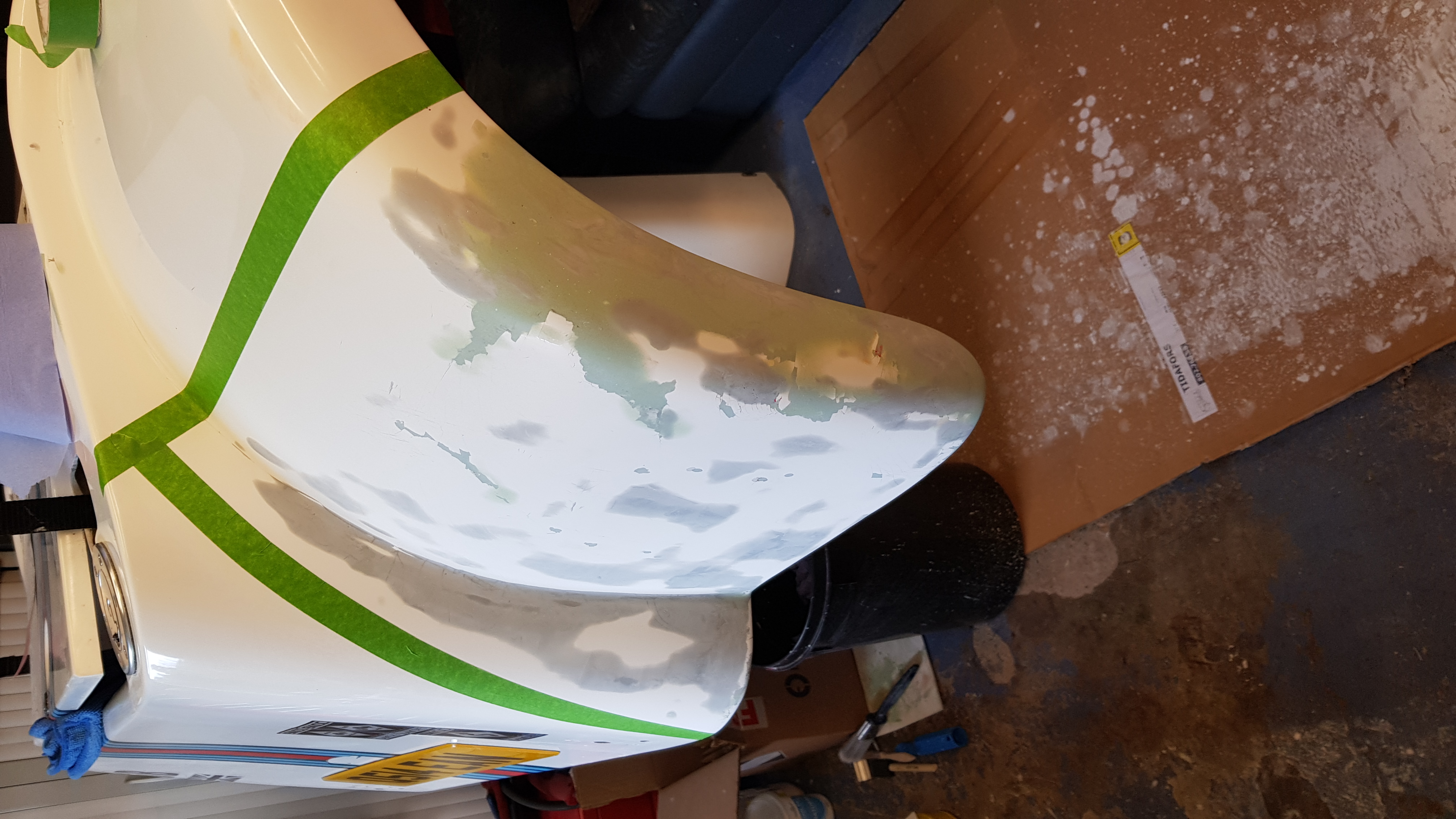

Many iterations of filling and sanding it is nearly there.

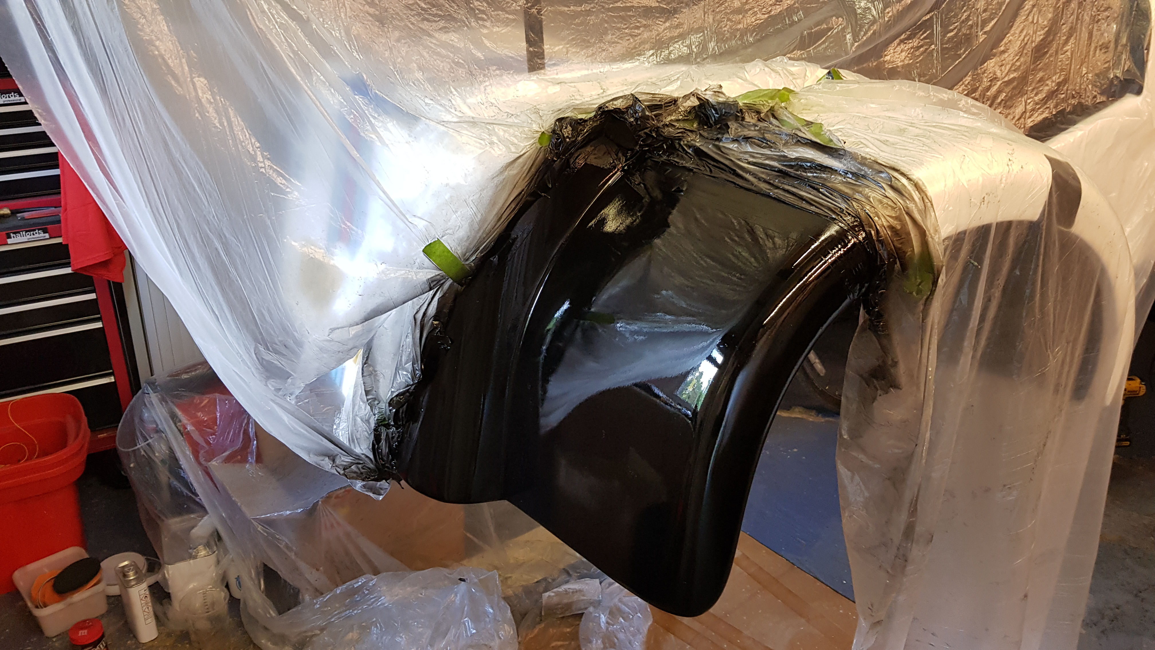

Postby David T » Sat Jul 21, 2018 10:04 am
Now painted. Unfortunately this is not the end. A mould needs to be taken, this arch cut out and then a new one laid up. It looks sound but is demlaninated in places and for sure splits in the gel coat that have been filled will surely open up if driven. So, tomorrow it is out with the T-Cut and then a mould taken. I'm going for a split mould so that it does not lock itself around the arch.
Edit: Mrs T was a bit concerned the garage had been set up for a gruesome crime. :lol:
