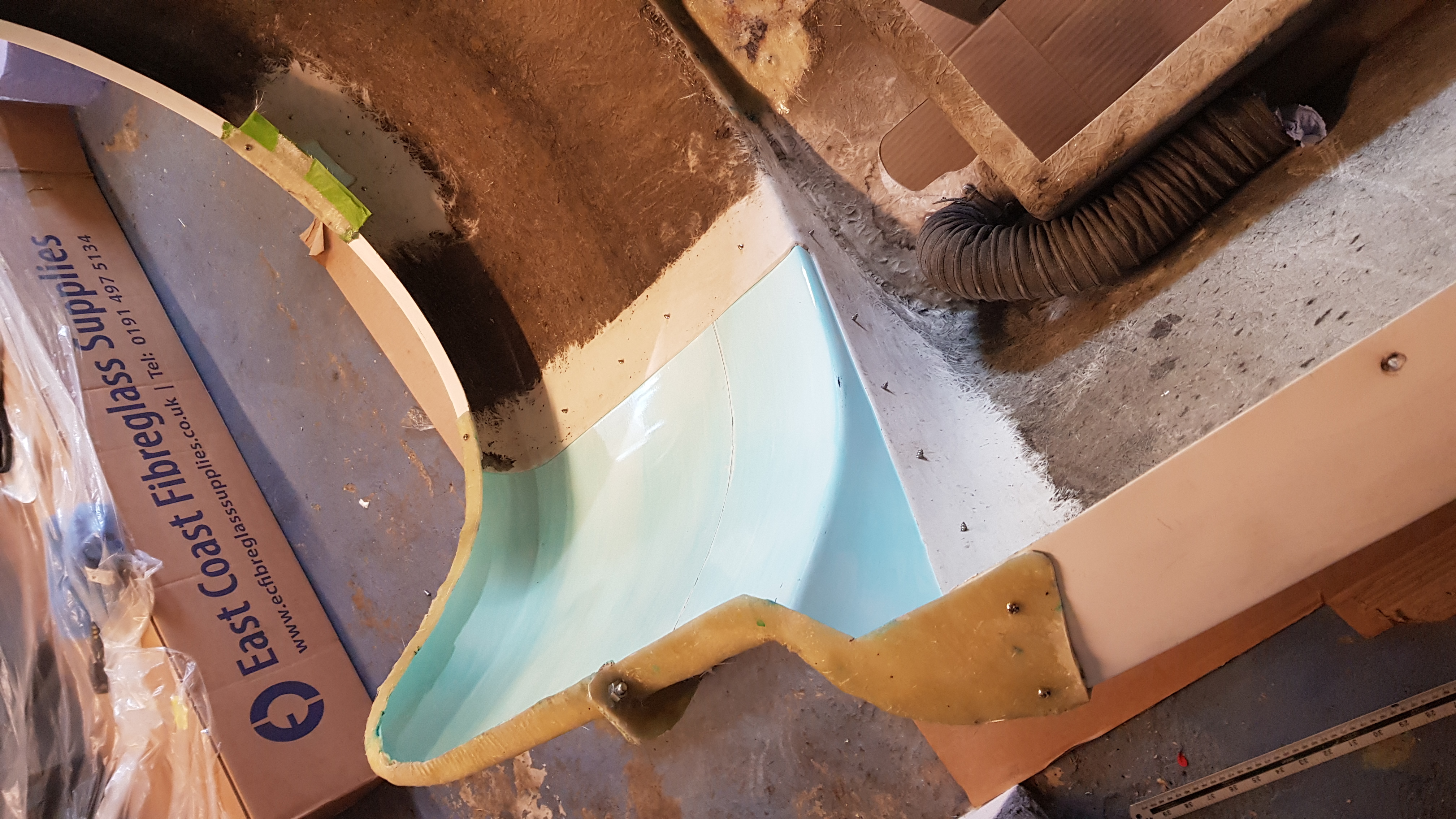

Postby David T » Mon Jul 30, 2018 12:49 pm
And the previously made repair mould for the smaller damaged area. This was taken off a good part of the arch further up.

Postby b33fy » Mon Jul 30, 2018 8:28 pm
That is serious work David. Looks like your fixing the mould to the car and making in situ? What do you do where old meets new?
Top stuff, well done for persevering.
Re: Buffing out the armco scuffs - sit rep
Postby David T » Tue Jul 31, 2018 8:23 am
Mike, as the Avon tub is one piece, any kind of repair or even a new arch, if they were available, would have to be grafted on. To fix new to old, the old is filed to a taper then after adding gel coat and tissue, ever larger pieces of mat are laid on top so giving a decent area of overlap. Going for 3x 600g/m2 should give about same thickness as original. That's the plan anyway.

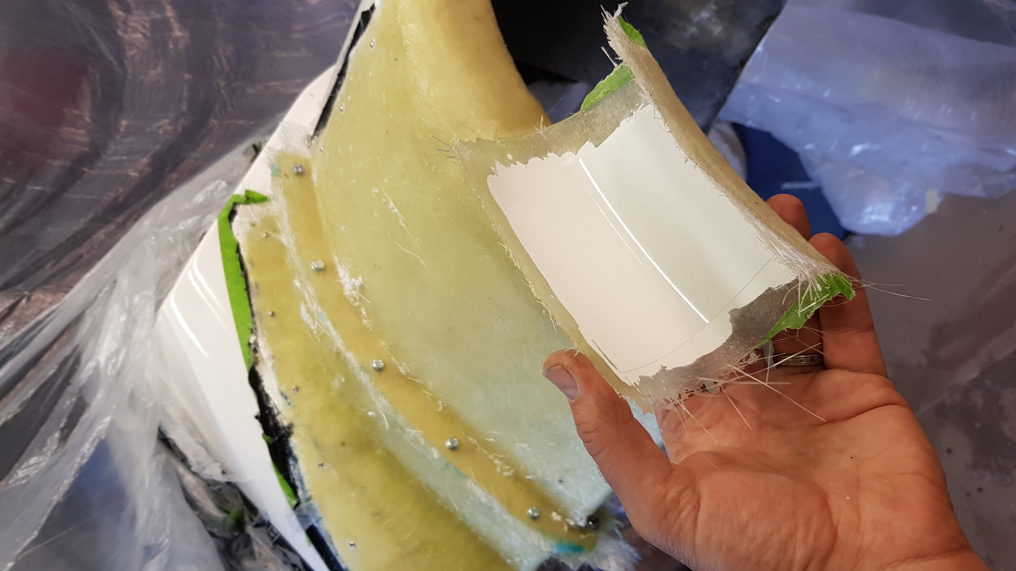

Postby David T » Wed Aug 01, 2018 10:08 am
Kinda like this.

Postby David T » Wed Aug 01, 2018 10:10 am
Tony, due to the extent of the damage it has to be done thoroughly or only alternative is replace whole tub, then find nose and bonnet don't match faded gel coat and have to buy complete bodywork set, etc.

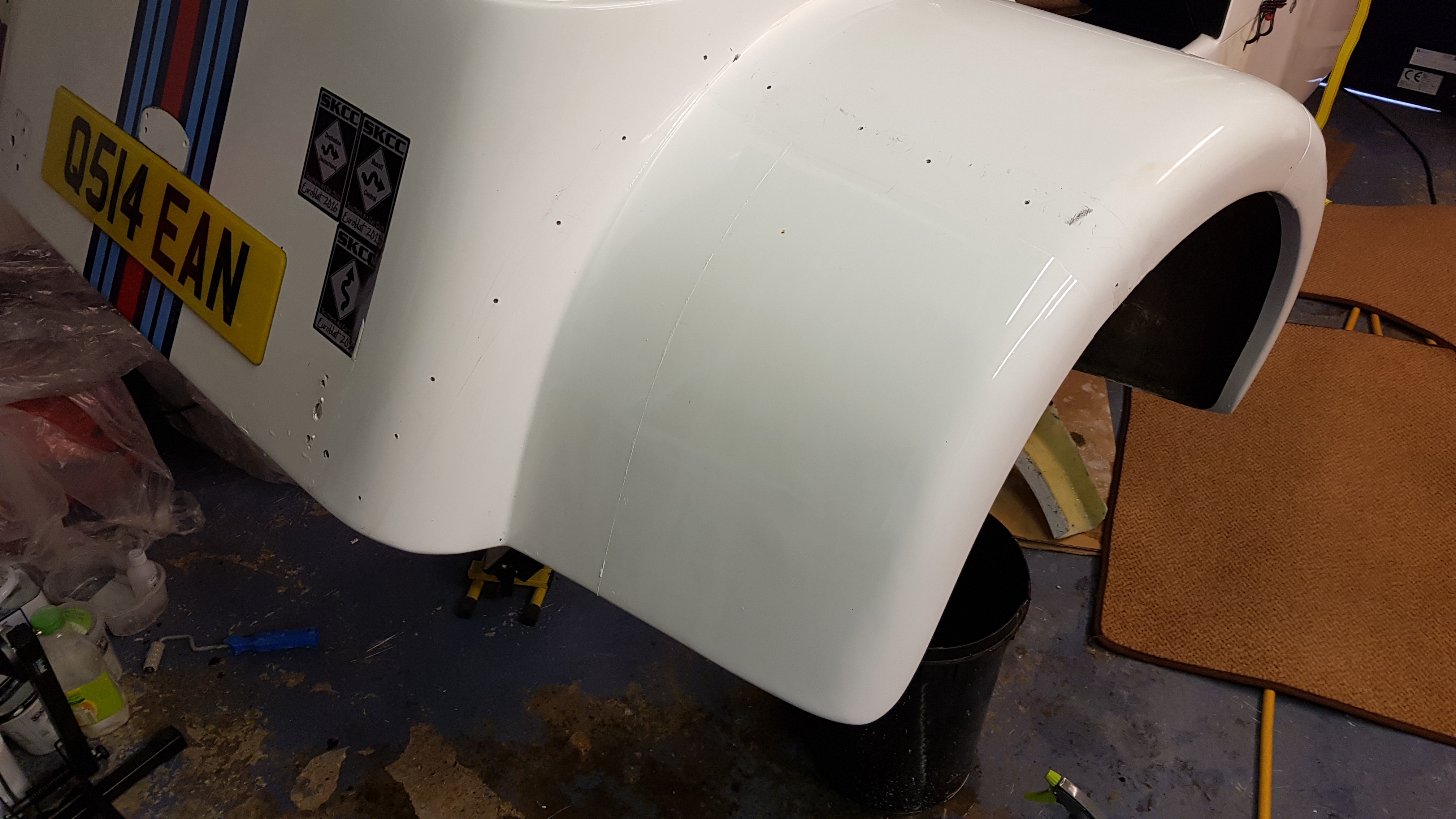

Postby David T » Mon Aug 13, 2018 12:23 pm
Moulds now off and I'm really pleased with the result. Thicker gel coat and white layup resin cured the gel coat translucence found on test panel. Just need to fill the screw holes and then time to refit to car (with France trip looking next month I've decided priority is now to get an MOT and then beautify later, eg smooth down the joins and mould flash line, paint, etc).
