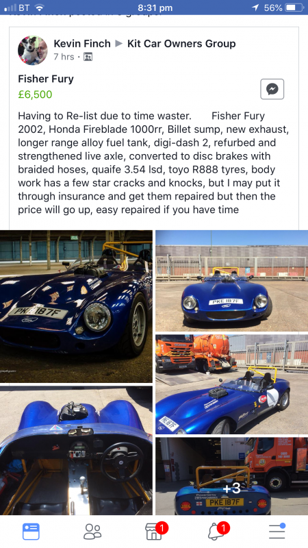

I also like the fury’s, here’s one for sale at the moment from someone who used to be really active on here....

£5k-£6k will get you a lesser or older spec’d Car but not likely to get you much in the bec market. Kevin’s blue fury is a lot of car for a bec and it has a AB Performance fireblade in it so would be worth taking a look at?
