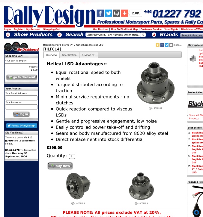

I was looking at one of these blackline diffs and wondering if anyone had heard anything about them good/bad?
