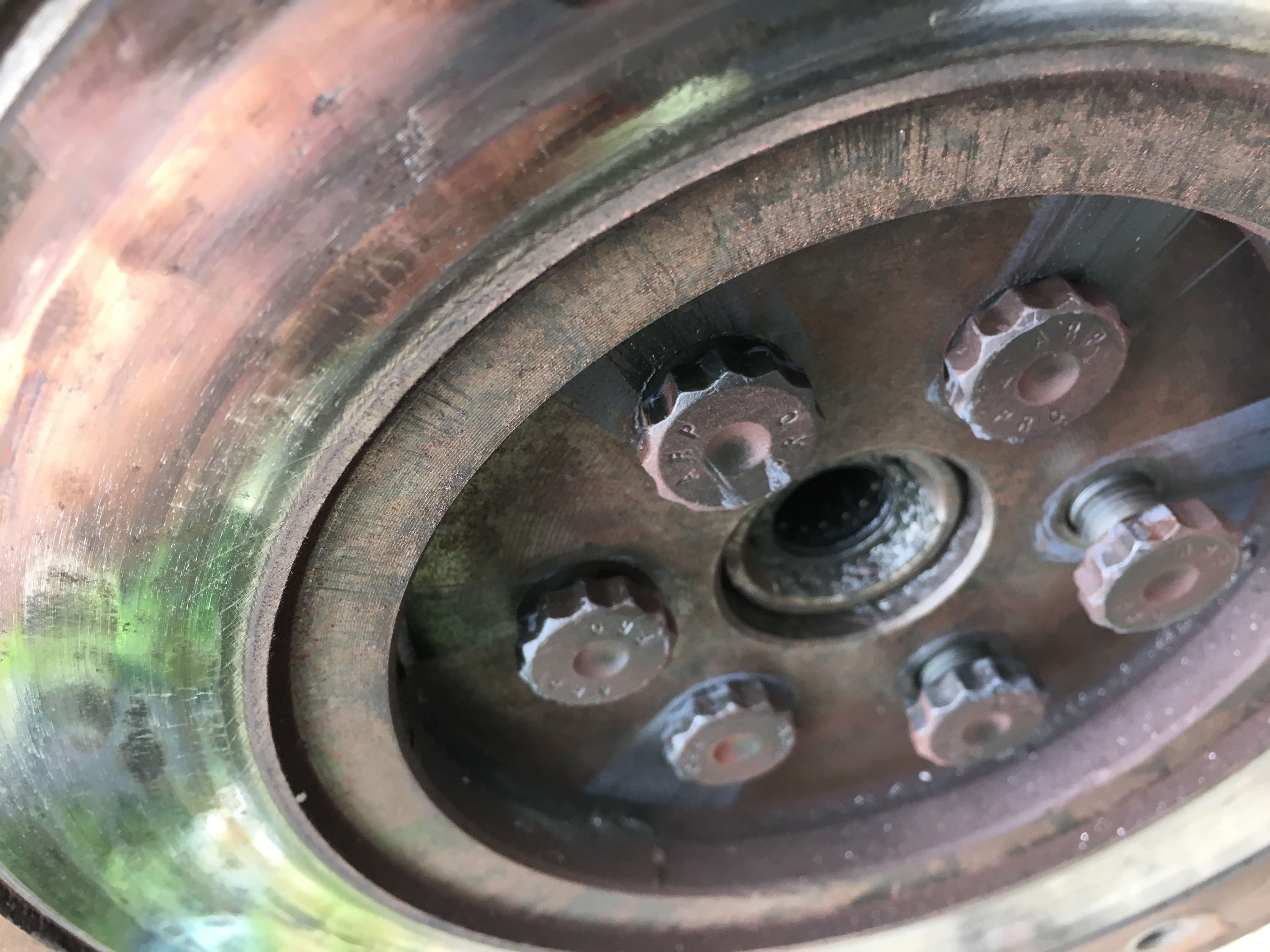

We started the car up and it made a right racket, sounded like a old Transit van, now bare in mind the car hasn’t moved or turned over.
We was checking everything, sounded as if it was top end, had cam cover off,checked clearances, all seamed ok, then we started to look at gearbox, startermotor and then Matt checked fly wheel to see if anything had broke off through the starter motor hole.
Same thing again! Fly wheel was loose,
hopefully it’s just the bolts that are loose and not something to serious
So engine has to be pulled, to get to fly wheel

Postby Matth93 » Mon Jun 04, 2018 2:10 pm
Engine is now out and this is how I found the bolts

Postby Fury1630 » Mon Jun 04, 2018 6:00 pm
They're ARP bolts not ford ones, I'm guessing someone's confused Nm with lb ft or just forgotten to torque them up at all.
