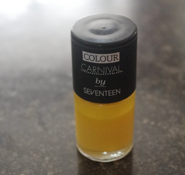

If only there was a plasticy kind of paint that was available cheaply in a lot of colours & in small pots - maybe with a brush already attached ....
Oh - wait
