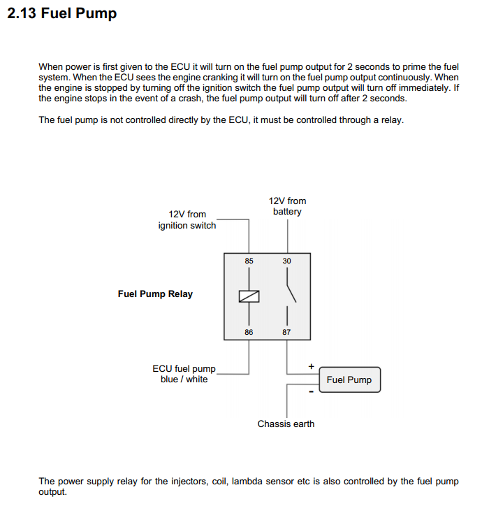

If you load your map in Map3000/4000 either from a saved copy or by connecting to the ECU you can see what the auxilary outputs are set to. In my rather retro Omex 550 I can only select a single aux output, either fuel pump enable or tacho - mine is set to engage the fuel pump.
Yours is the 600 or 700?
From the 600 manual it doesn't look like you can select the fuel pump or not: 2.13 Fuel Pump: "When power is first given to the ECU it will turn on the fuel pump output for 2 seconds to prime the fuel system. When the ECU sees the engine cranking it will turn on the fuel pump output continuously." and then at the bottom "The power supply relay for the injectors, coil, lambda sensor etc is controlled by the fuel pump output.".
Which makes me wonder if it's not 'seeing the engine crank' and not providing power to the injectors/coil/etc?
Here's the page from the manual:
Cheers,
N

ncd wrote:Which makes me wonder if it's not 'seeing the engine crank' and not providing power to the injectors/coil/etc?
I've wondered that & it'll be the first thing I check this morning. I've had the dash out of the car & I'm wondering if I've disturbed something.
That wiring diagram is different to the one in my book. I think there must be a new issue as there's no "2.13 Fuel Pump" section at all.
Investigation required.
Thanks all.

Postby Fury1630 » Sun Jan 06, 2019 3:06 pm
There's some strangeness going on here - of my own making I'll grant you.
There's two relays behind the dash, one has a fat red (stop me if I'm getting to electronic), a thin red, a green & a Blue / white.
The fat red is permanent live
The thin red is ignition live
The green goes to the coil
The blue / white goes to the ECU where it's earthed with ignition & cut two seconds later
So, as experienced, the engine will run only if it fires within the two seconds. I put a non switched earth in place of the blue / white & the coil stays on & the engine fires.
So you may well ask, why have I got the coil wired to the fuel pump relay?
It's a question I've been asking myself, along with how was it working before? & what's changed to make it not work now.
Just to add to the confusion, next to that relay is another one - not working - aha! I thought, but it's switched by the fuel pump switch on the dash & energises a wire that goes no-where in the engine bay - I think it used to drive the HP pump when that was up front.
So I seem to have fixed the fault without ever knowing what the fault was.
