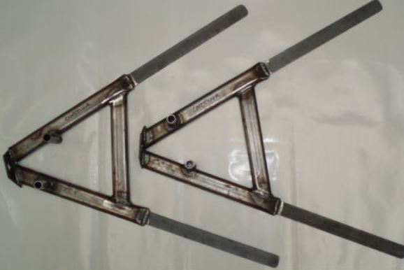

I am shortly going to change my clam shell wings to cycle wings, I have got a nice new pair of wing stays (in-bent) and the question is.. What is the best was to bend the stays to match the radius of the new wing. I could easily follow the tyre radius but that’s not really going to fit the wing!

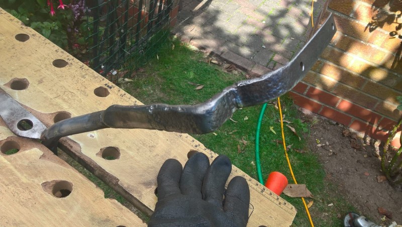

I shaped mine to follow the shape of the inside of the arch as close as possible then at the inside edge cut and welded a tightly bent piece to step it inwards so that it missed the outer edge of the tyre and also the side wall. Will look for a pic of take one tomorrow
- Posts: 4497
Re: Wing Stays Bending
Originally I had the flat strip as 3mm, these tend to break so most of the flat was beefed up to 9mm.
This then attaches to the caped off end of a piece of conduit and joined all together at the callipers end.

Its more how you go about getting the correct bend on the top bars that I am asking about, I also plan on adding a ply wood spacer between the tyre and the bracket to get the correct spacing. Then I guess go from there to see how they line up. Will keep you posted on progress. I also plan on bonding them on with adhesive as do not want any visible fixings.
