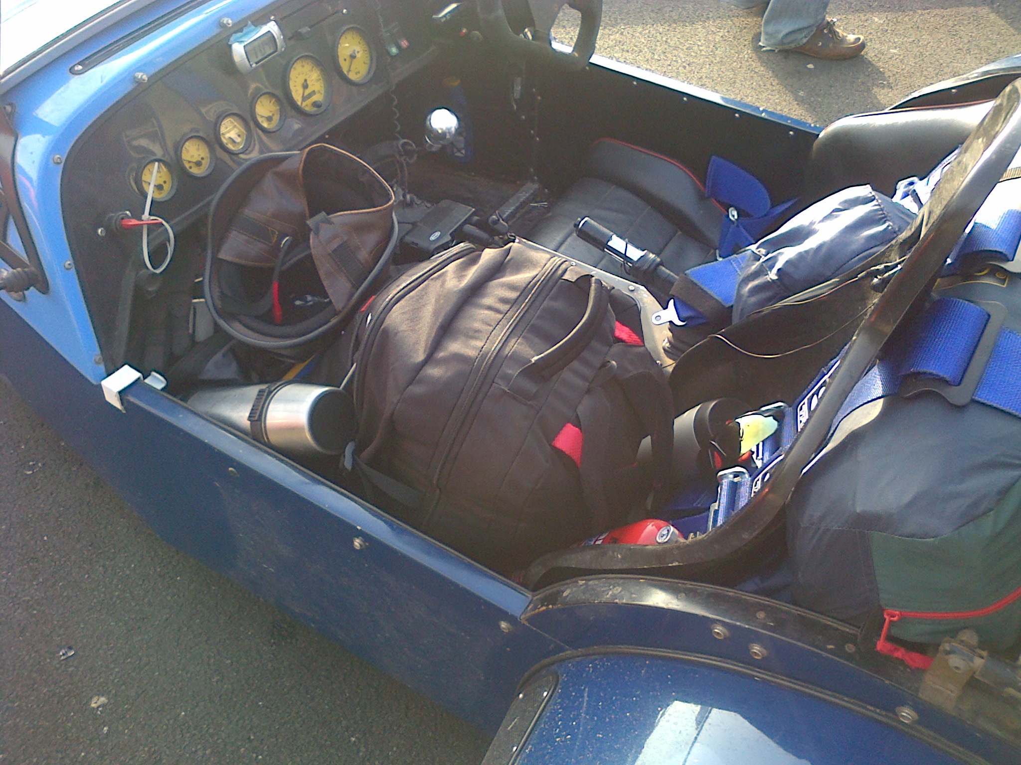

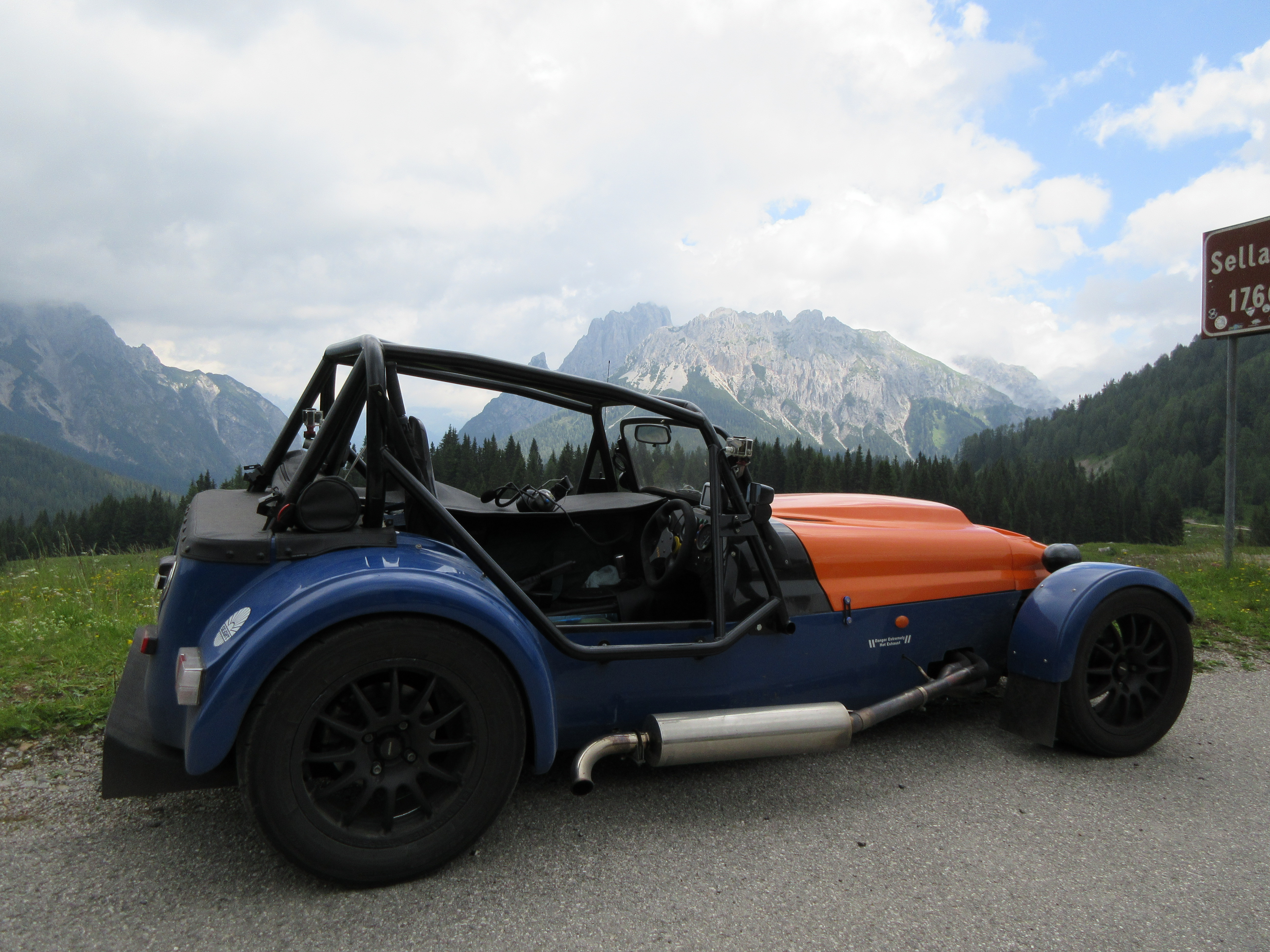

Hi this is my car on tour. No luggage rack, everything is in the passenger footwell.

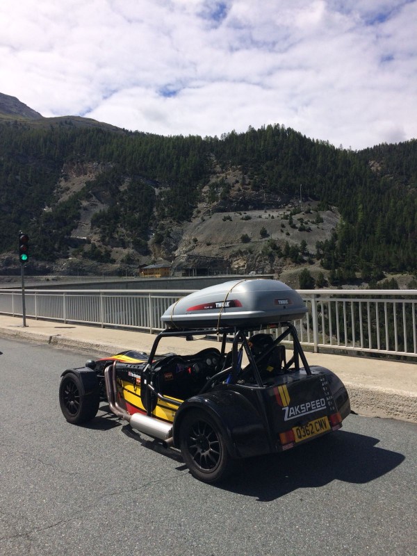

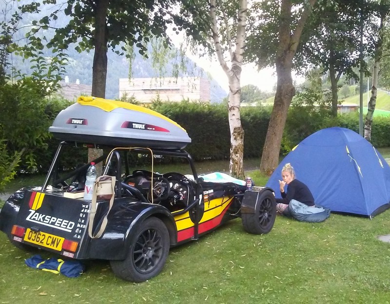

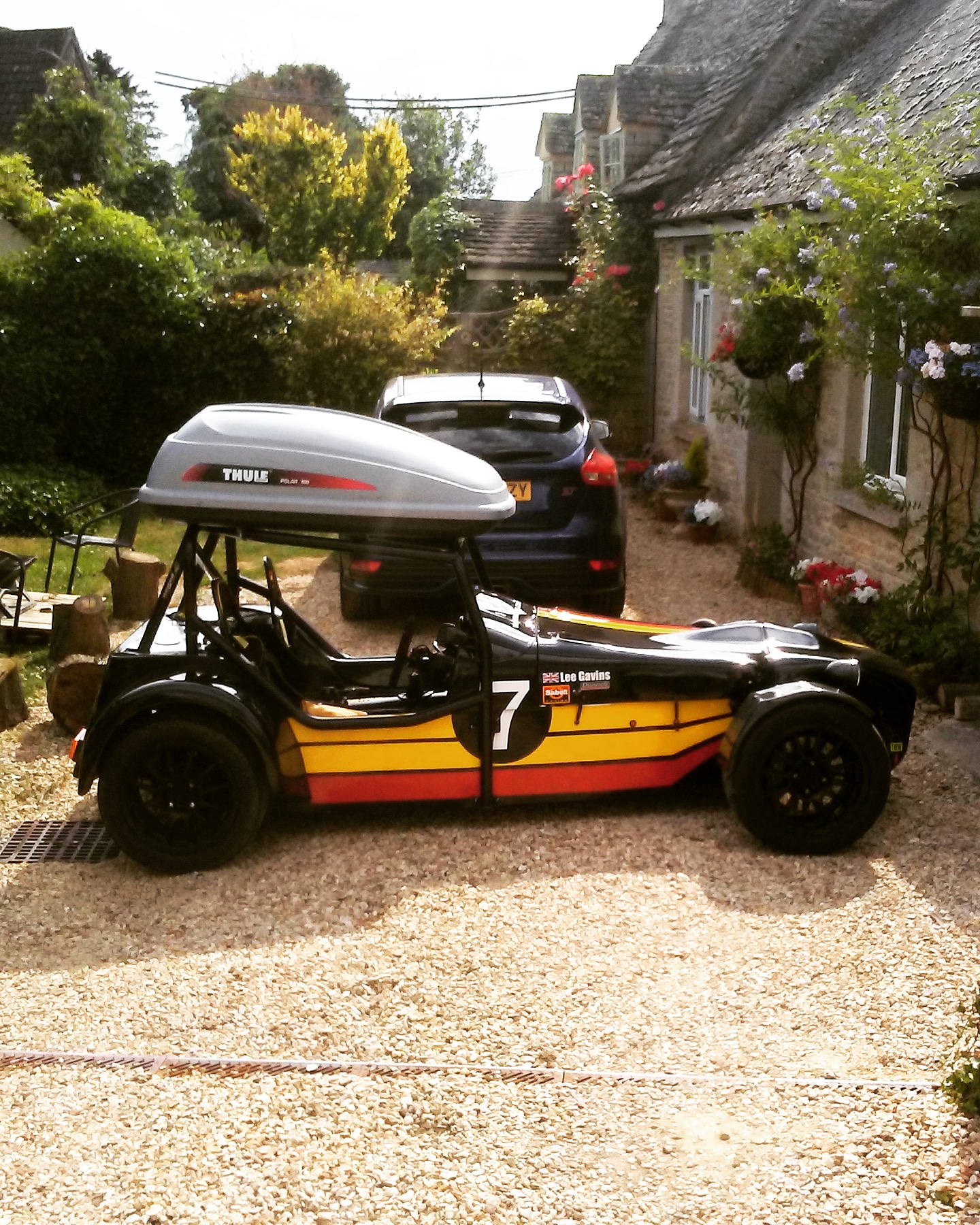

hi Rod, this is waht i did for mine and the mrs trip down to lake como last year. previous trips to the alps and Europe ive done what kenton did and stuck it in the footwell. Used U bolts with big washers inside the roof rack drilled through. no problems at all.

fully loaded.

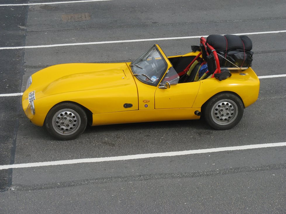

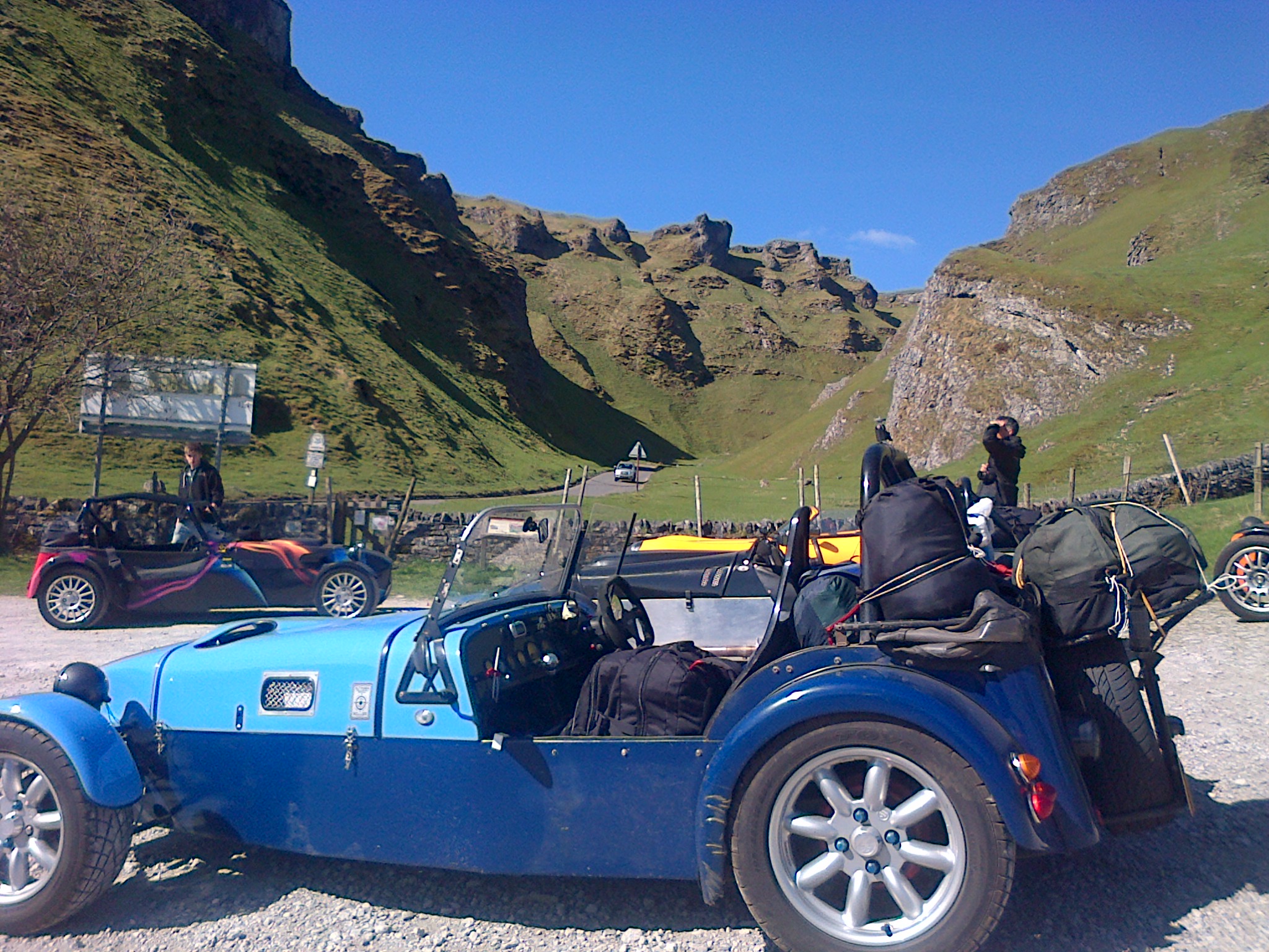

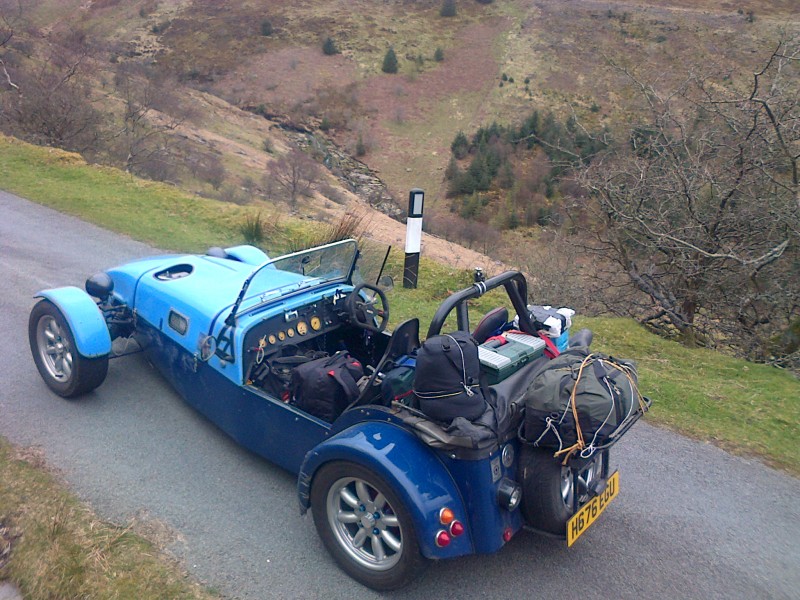

A bit like this you mean from our 2013 tour of Wales
plus the stuff inside
i also have a coffin where the pass seat should be now as well,.
Richard

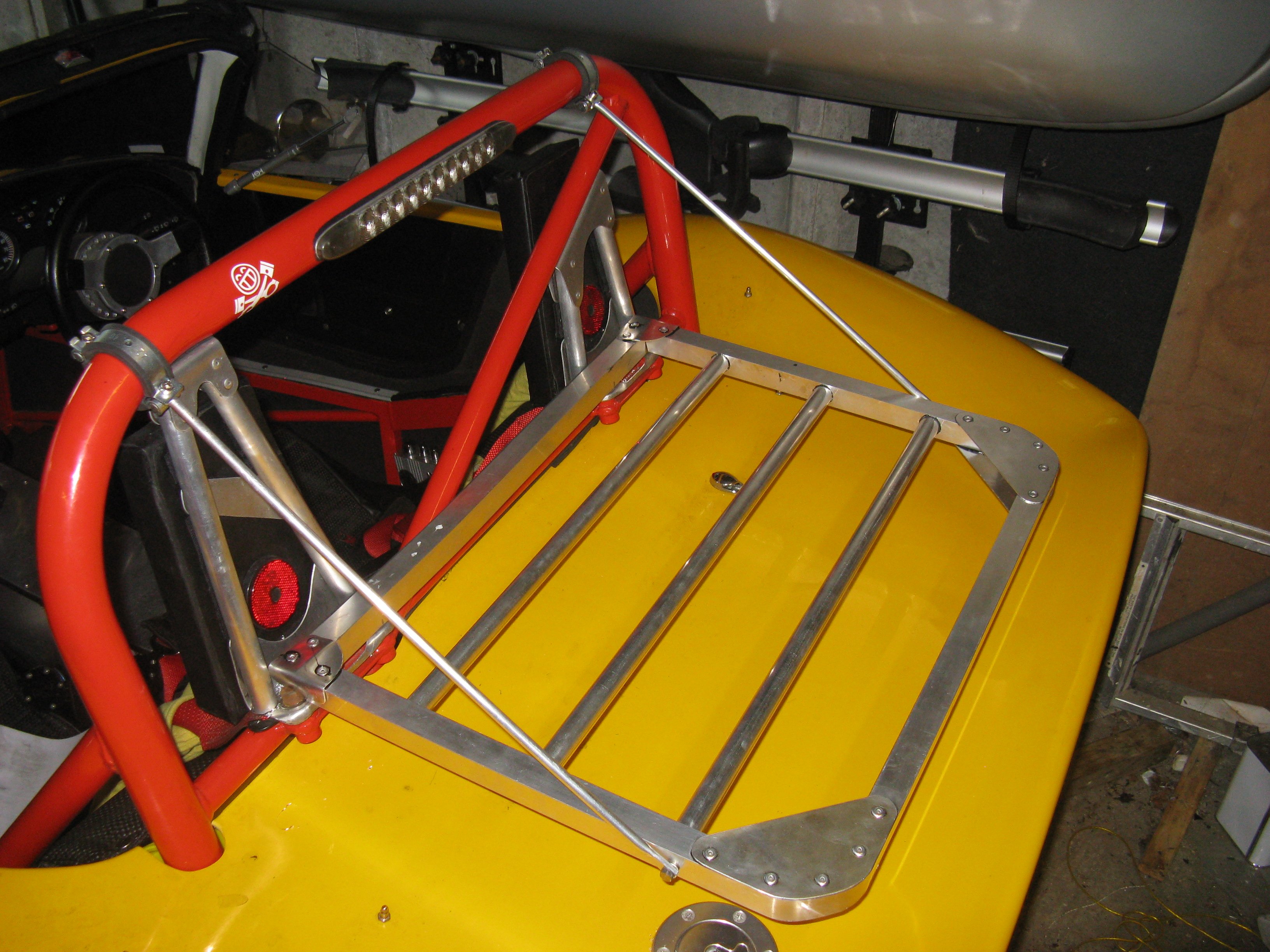

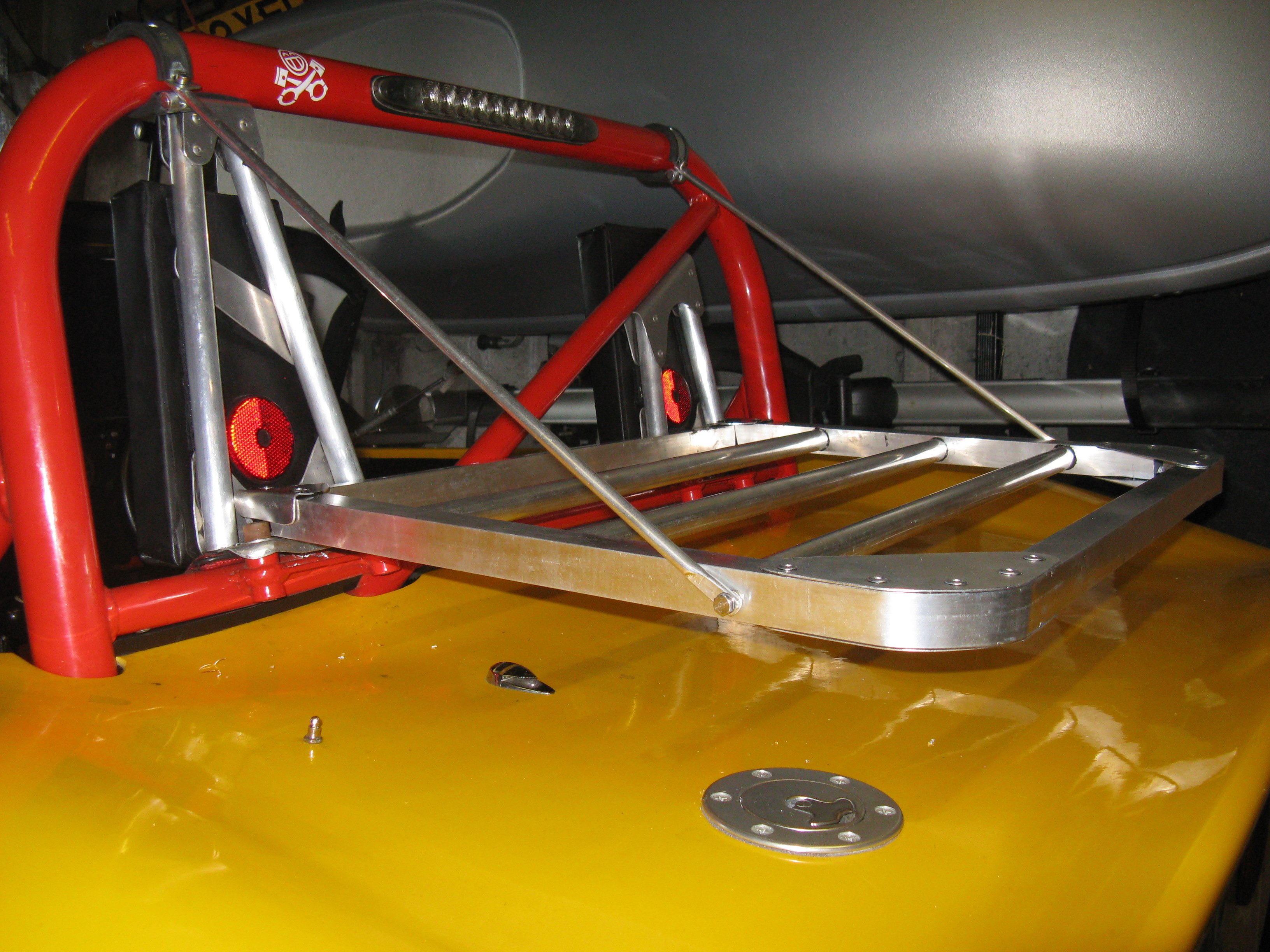

OK, I'll be the sensible one

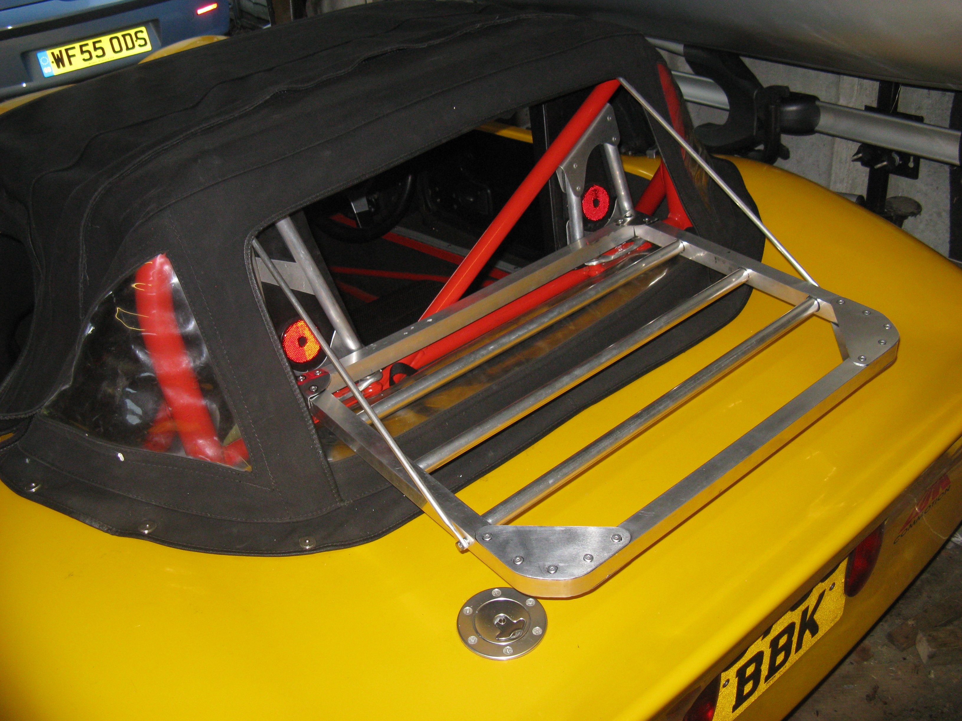

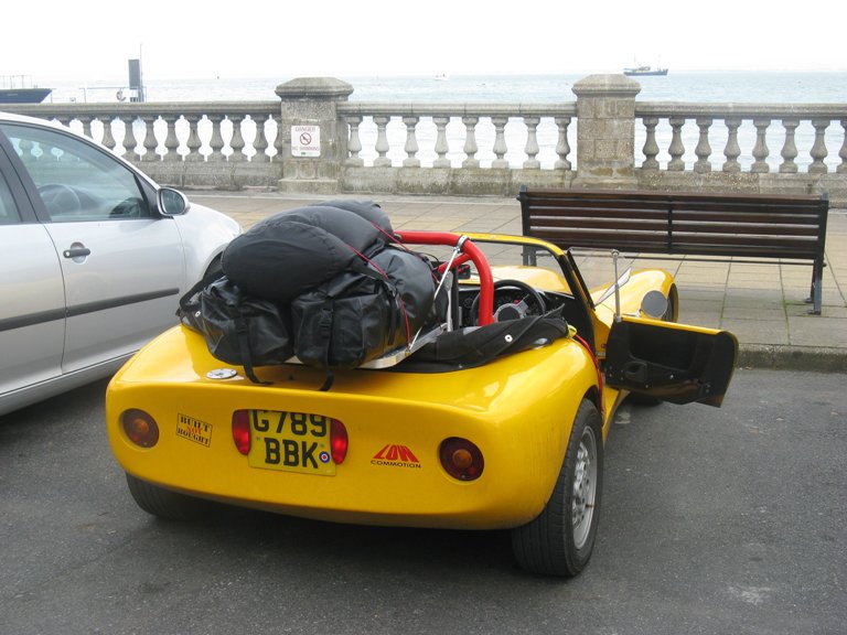

I have a light rack made from Alloy extrusion, at the front it attaches through two brackets bolted to the upper seat belt mounts, at the top a couple of pipe supports hold it to the top of the roll bar. It's made just the right width to poke through the zip-out rear window in the soft top & because it's all on quick-release fittings it goes on & comes off in seconds.
Full details on request - particularly good if you're having trouble sleeping.
