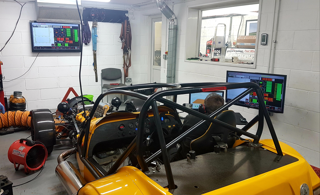

Anyway, a trip to RLM Racing was scheduled and I booked the day off work. These guys are experts at building, modifying and tuning the hayabusa engine. They are a very long way from me, but I figured it's better to get these things done properly. Their brief was to get the engine running right and review and tweak the ECU map with a rolling road session.
Set off mega early and arrived 3 hours later at 08:40 in a small village (town?) just north of Corby. All good - got a coffee on arrival and explained the issues and car set up, and then set about taking the body work off and allowing the guys to strap the busa down to the rollers.
Now - I've never had this car rolling roaded and never seen a power figure for it. All I know if the previous owner told me it had made about 210 at the wheels in 2015/2016.
The car was warmed up and then given a power run up to 9,750 rpm to see what it was making, and to set a reference point for the work that was to follow. Figures were pretty good actually... 229 bhp and 144 Ft.lbs.
Rich at RLM then set about calibrating the TPS so that it was matching the figures that the ECU was expecting to see (1.18v at idle), and then the next two hours doing multiple runs on the rollers to tune all areas of the ECU map - loads of time spent fine-tuning the low-end and mid-range stuff, and transition when coming on the throttle.

The car behaved really well on the rollers. The guys at RLM said they wished that all rolling road sessions went that smoothly. Nothing broke or needed fixing, no fluid leaks, no over-heating. The guys seemed pretty impressed with the engine, considering the budget nature of the turbo conversion.
