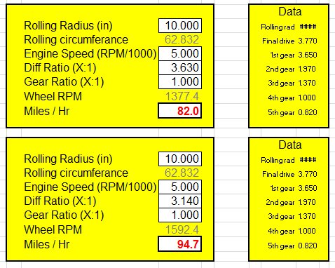

Hmm, this is a maths question.
Fortunately many years ago I made a spreadsheet to answer this question.
In this snapshot you see a Type 9 in 5th driving a 1:3.63 diff in the top box, with a rocket in 4th driving a 1:3.14 in the lower one - pretty much the same speed.
In this snapshot you see a Type 9 (or Rocket) in 4th driving a 1:3.63 diff in the top box, with a Rocket in 4th driving a 1:3.14 in the lower one - so that's the difference in speed, all else being equal.
MPH-RPM 2.jpg (61.29 KiB) Viewed 3241 times
The difference between the two boxes is that the type 9 has a ludicrously low 1st (for getting a laden Sierra moving while towing a caravan) & 2nd isn't much better, but the Rocket box's closer ratios will be a little wider spaced with a taller diff, but still closer than the type 9s.
I'm not advocating either - what's right for you isn't right for someone else, I'm just suggesting an alternative :geek:

Now that is exactly what I was looking for, wow! You Sir are a legend, great work on the tables!
I will digest this and take a long think!
