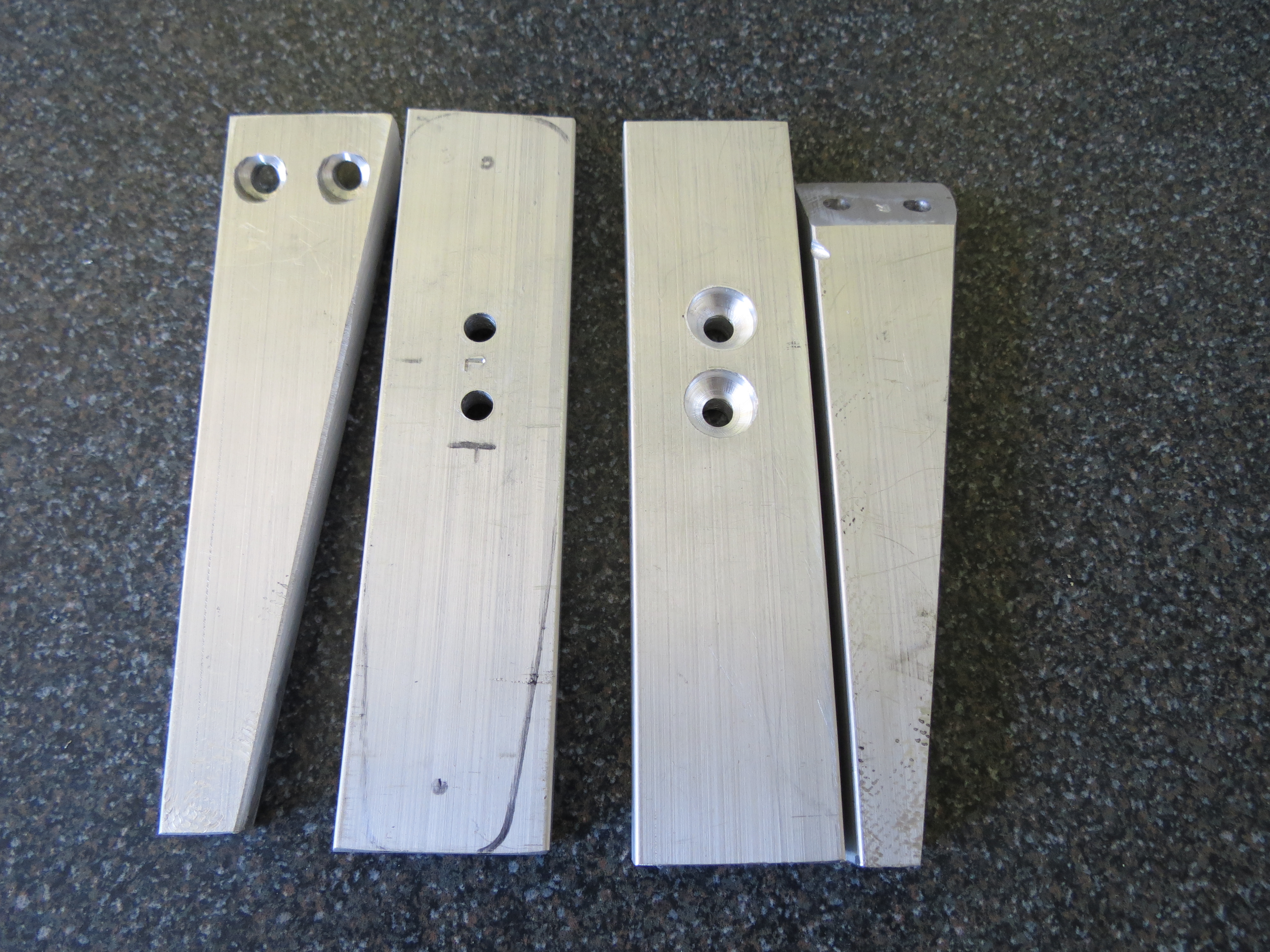

I bought a bar of aluminium alloy from Ebay. It was 30mm x 10mm x 500mm for a quite reasonable £10.50 delivered. I had a design in mind, and initially thought I would weld the pieces together. I cut out the blanks with hacksaw, and angle grinder. The most difficult part was beveling the ends of the arms.
Once I had the pieces in my hands, I realised my chances of clamping and welding the pieces in exactly the right place without any cock ups weren't good! I decided I would have to bolt them together first to make welding easier. Here is a photo of the rough formed parts:
and also bolted together after a bit more shaping:

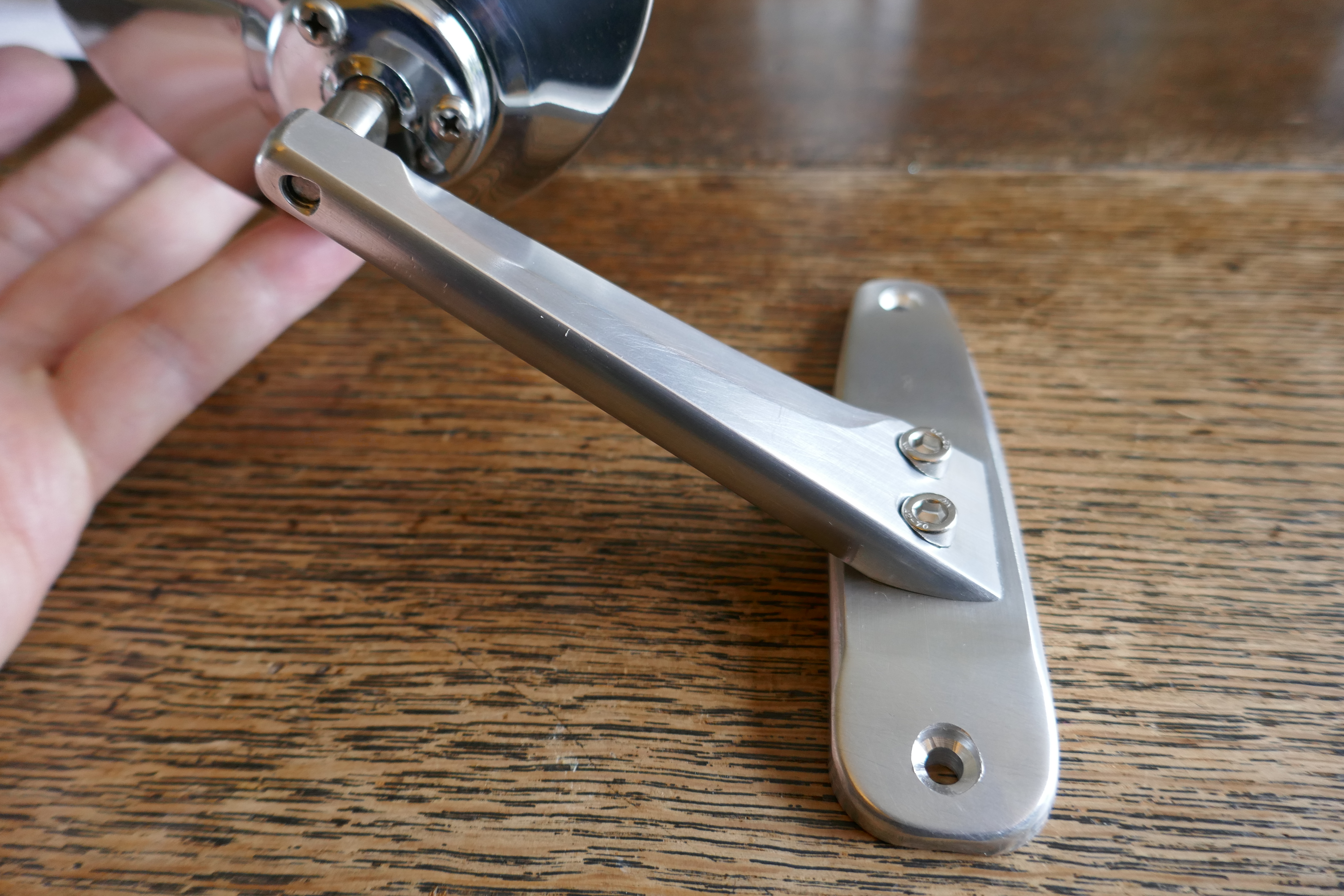

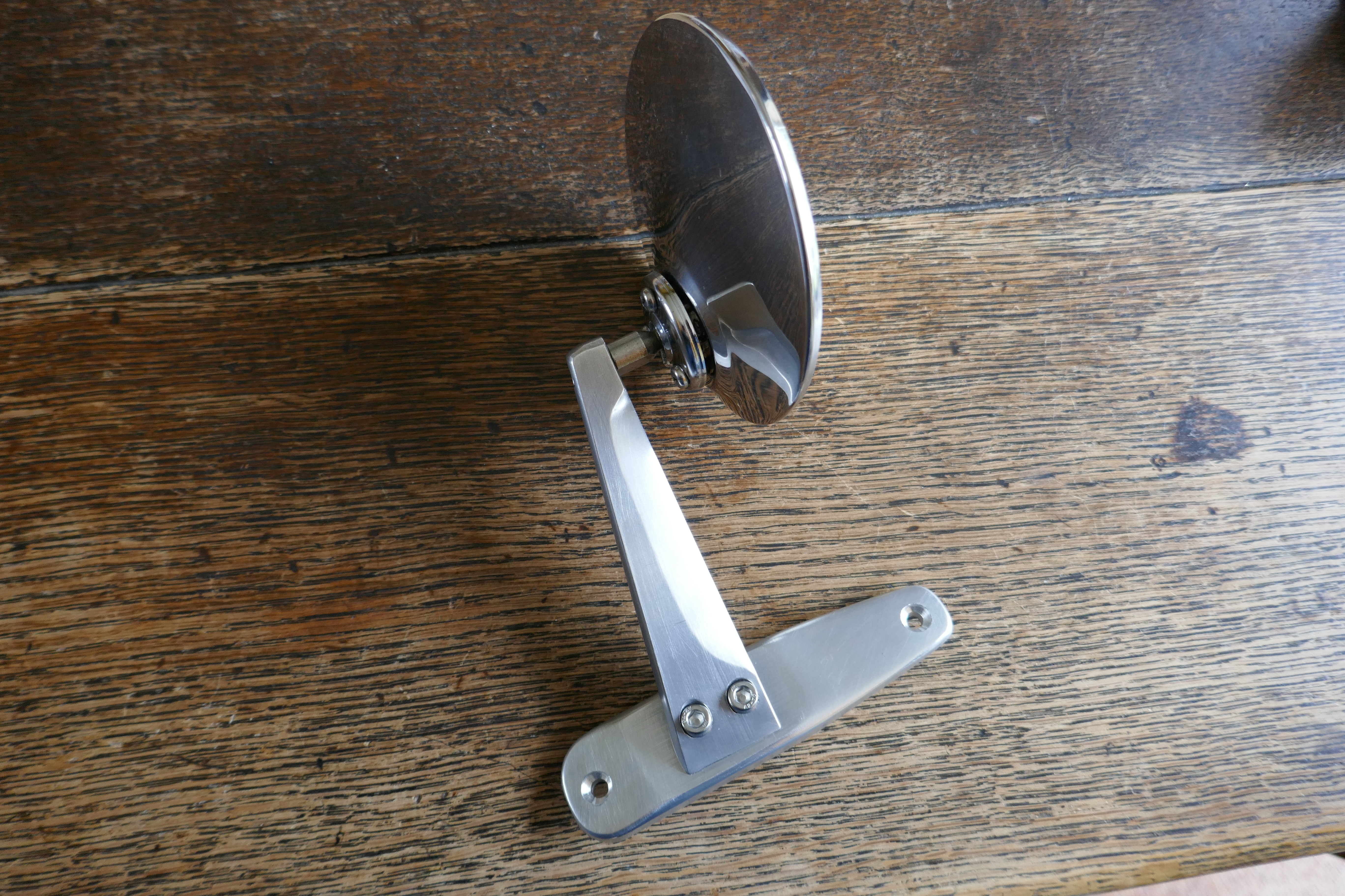

Next came quite a lot of smoothing, shaping and polishing. I tried to make them a little lighter and look at least a little bit aerodynamic. I considered drilling lightening holes, but decided trying to clean those would be a nightmare.
Here is a photo of the polished parts:
And here assembled:

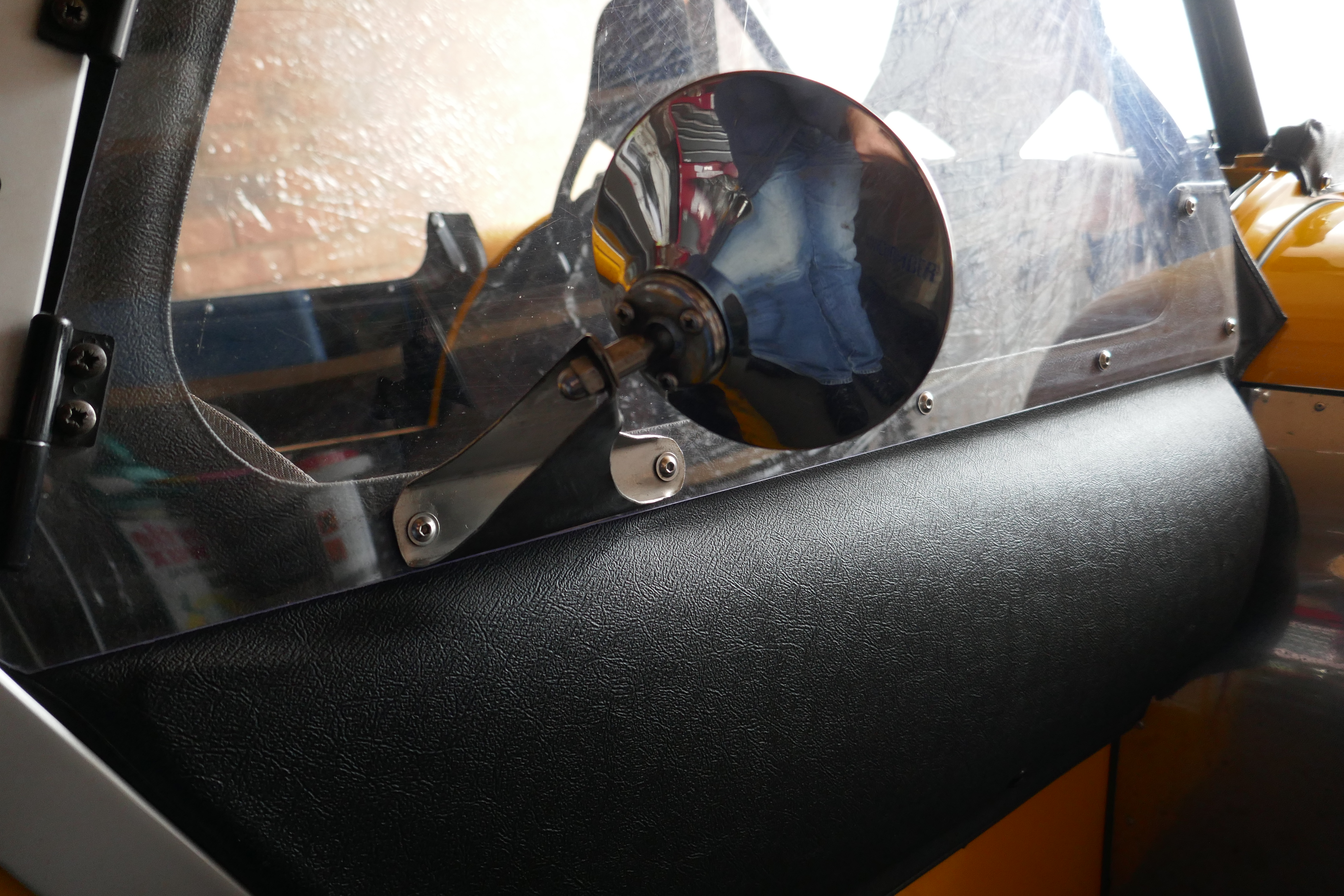

This is the finished mount with mirror attached:
