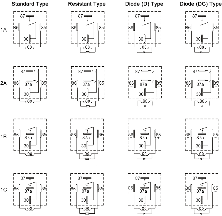

Replace all your relays before doing anything else Russ. I spent weeks chasing electrical gremlin in my new car that would cut the car out, sometimes it would start then it would cut out. I spent ages( weeks )proving everything else was ok. Finally changed a fuel pump relay and it stopped it for a while. Then started again. Chasing round for ages again.. turned out the fuel relay was linked to the power relay and it was the power relay that was faulty in the first place, intermittent internal connection. Spend the few quid on relays and change em all first. Sounds like a relay issue to me. Just don't make the same mistake I did during the process and fit a wrong relay... Make sure you get the exact same one with same internal layout.
