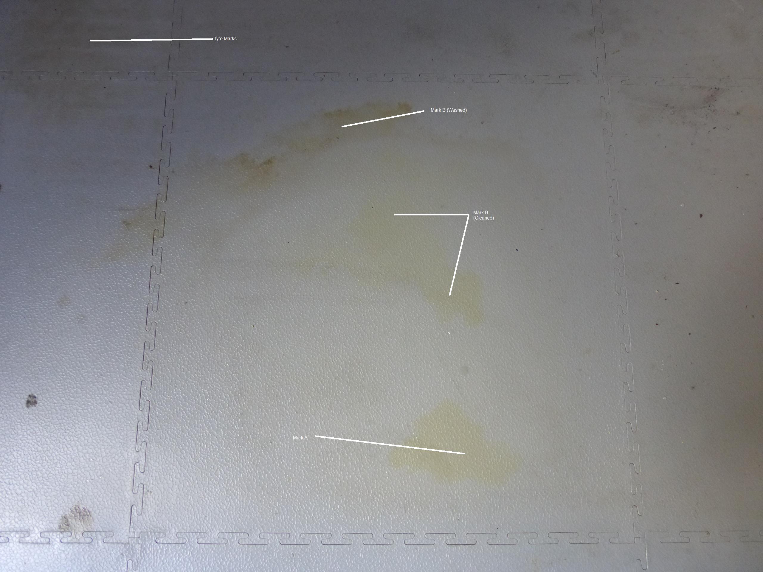

Well in the end I went for a painted floor around the workbench area - some rubbery type paint from Brewers and seems quite good. For the main floor I went for 7mm (quality ones) tiles from GarageTek that ultimately came from EcoTiles. Finally completed floor in light grey where cars stand and blue for surround with yellow trim. much impressed when I fitted it all in March.
I happened to spill some petrol in May and again in June and found the light grey tiles had stained. Then a week ago noticed a couple of oil drops from my Dax that missed my drip tray. Initial response from manufacture was it must have been an additive or warm tyres. However they (EcoTiles) have just turned up on site and told me yes, all tiles will stain and light tile colours will show it! They only recommend black / graphite tiles where a car stands so that you don't see the stains!
Hmm. Now would one not have thought garage floor tiles should not stain with petrol and oil? What is the point, otherwise. Having forked out £1,500 I'm a little miffed so now deciding what to do. EcoTiles say they tell everyone they stain however having read again http://www.ecotileflooring.com/applicat ... -flooring/ I cannot see this here. In fact they seem to suggest the opposite.
Does anyone know of garage flooring that actually does not stain?
They also say depressions from trolley jacks and axle stands may not come out especially after a period of time.
