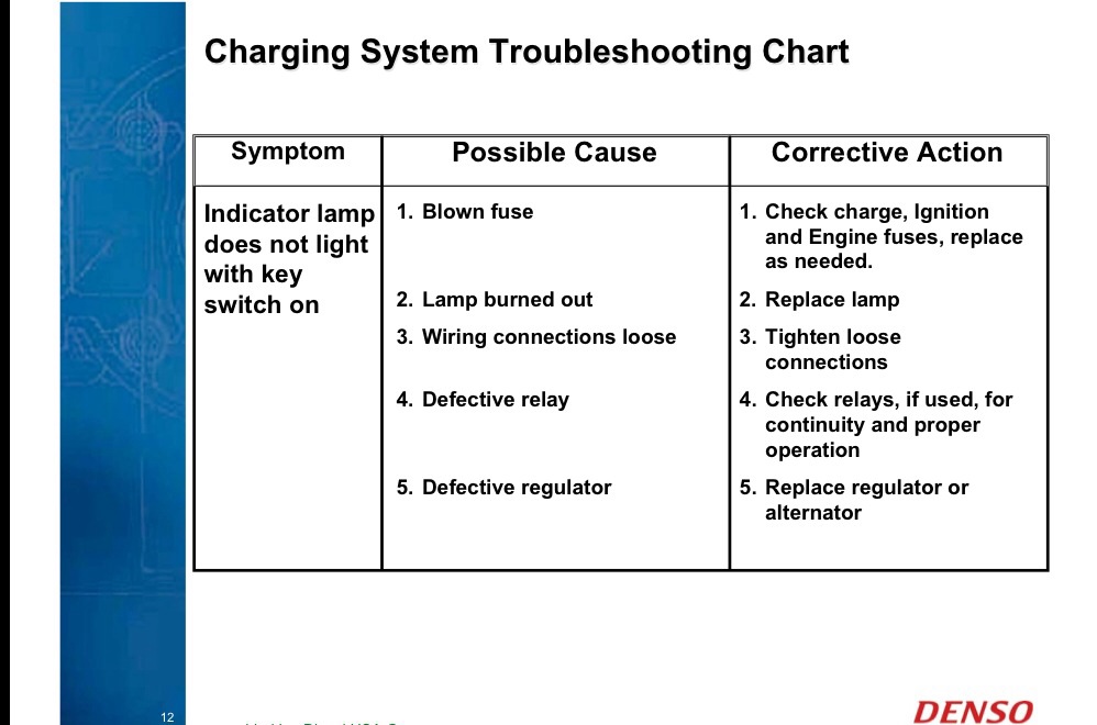

I've been looking around on the internet and have found a webpage which describes this fault and it suggests it's the regulator. Hope this helps

Regulator...
