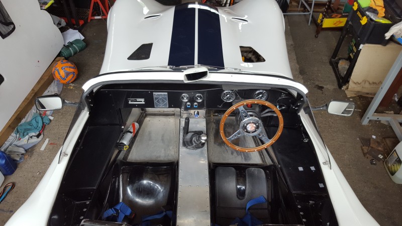

My floor has drain holes and is painted black

Drill holes both side of the chassis rail in front of the seats where the water pools
And either do without flooring
Or use rubber matting.
Keep the carpet for when you sell the car

My Caterham gets wet floors in bad weather ( as my previous Elan and Westfield!). I think the best option is to have bare floors under the seats with a hole in each side so water can run out freely. You need something grippy in the foot well so rubber mats that can be easily removed are best there.

yep as with the others, nowt in mine apart from the floor and a cple of holes......
'foot slippage'....really? can't say i've ever noticed/had that even without rubber mats etc....you do know you're not supposed to put wd40 on your shoes?

1/4 inch holes do the job, and I have plastic trim clips that I seal them with normally. It is quite satisfying taking the clips out and watching the water pour out.

Got Ali checker plate in the front section of mine that I can lift out to dry if needed and stops any foot slipperage and a few small holes in each floor section.
