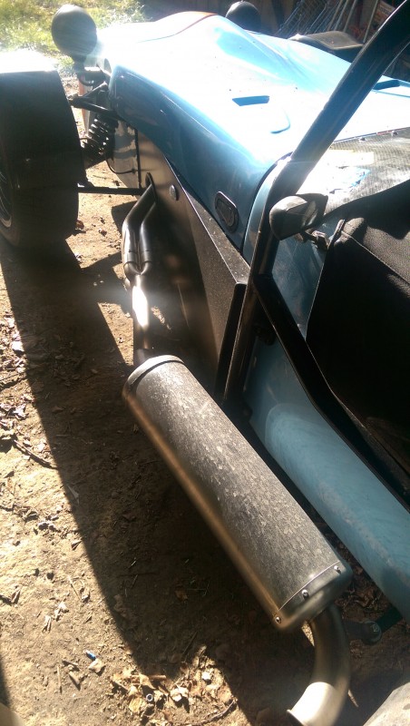

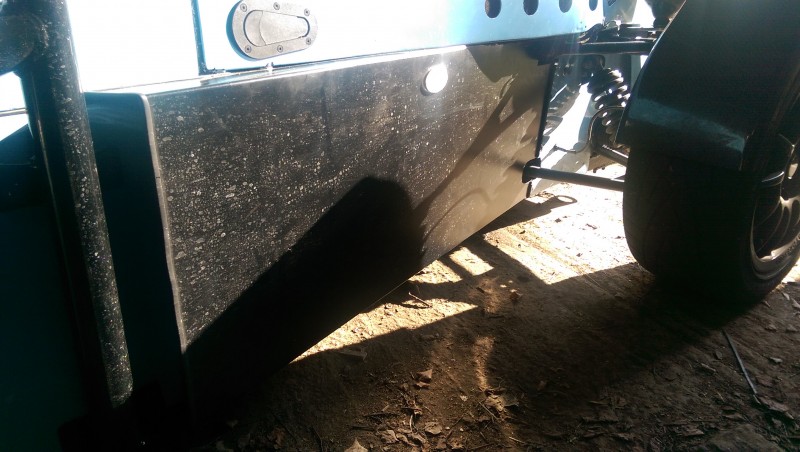

Aside from the diff being checked the other main aim was to fit the new bonnet, some will recall that the old one had parted company with the car and was more crazed than its owner. Go on take a guess, did the new one fit like a glove? Nope. It had a frigging gap between the bottom edge and the chassis rail. So we pondered, pondered some more, eyed it up and decided that we'd make ( i say 'we' ) some flared sides, that way 'we' could lose the gap.
Boy did they look big, and shiny - way too shiny....'err shall we powder coat them' ? Good idea and a very cost effective one at that! The flares weren't designed to take away under bonnet heat, they were to lose the gap, plus protect the rollcage that had been mullered by stones thrown up by the front wheels. 'Shall we give the 'coaters' the cage too'....yep, a no brainer.

Pass side/exhaust/flare
Drivers flare

Flares look proper they do. Do they vent from engine bay?

@ Rich......diff was found to be in good health. after extensive trawling have changed the oil type and the action seems far better..
@ David....ye the original side panel has been cut part way along the flare. Makes a huge difference to under bonnet temps. Barring some heat ( to the touch ) at the front of the bonnet most of it is cool.

Love the flares, somthing I'd like to do just to lower the temps and better than using a bit of bof roll to list the back of the bonnet
