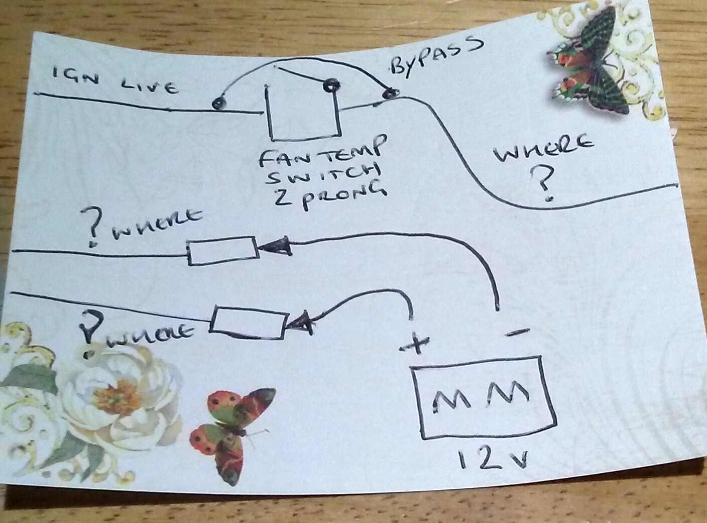

After purchasing a two prong temp switch i am having major issues wiring it up.
The wiring for the temp switch is hurrendous and im trying to figure it out.
This is what ive got... I have no idea where the wires go with question marks on...
I have bypassed the switch and then i have two wires which when i put a multi meter on and ignition on the MM reads 12v. Withought ignition on or the bypass it reads nothing.
Are these two wires what i wire up to the fan itself and can anybody tell me WHERE they are likely to go so i can inderstand how my cars wired up....

Lee, what sort of switch is it? and what connections are on the back of it? (Sorry two prong) What’s your fan/water pump setup?
Re: Fan temp Switch help
Postby Tony C » Fri Feb 02, 2018 9:55 pm
