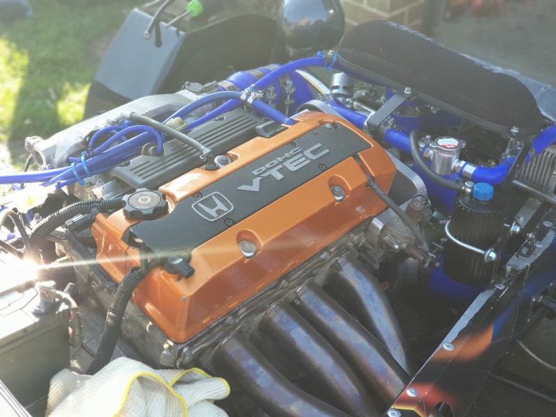

Nash wrote:The car just got through noise in the morning at 104dB :shock: and in the afternoon around 3.30pm after about 60 laps of running I had it checked again and it came in at 100dB. The induction was/is louder than the zorst now so I need to think about that.
Happy days.
That is possible because acoutafil needs heat in it to expand to fill the silencer. The induction noise will be a product of the sausage filter you are using, I ended up putting the big K&N filter in a box and piping cold air to it.
Happy days.
Yeah that's my thinking too Jeff. I'm struggling for space to duct to a suitable spot.

Postby jeffw » Tue Feb 26, 2019 6:21 am
You will do. Most of this sort of stuff went on in the side pods in mine which you obviously don't have.

I know that the BEC guys struggle with induction noise. An air box seems that way to go, although I'm sure space is it a premium under your bonnet!
Re: Brands Hatch First Outing
Postby Nash » Tue Feb 26, 2019 6:32 pm
SteveRST wrote:Need pics Neil!
Good job getting it a fair bit quieter now.
Steve, Can't believe I'm going to say this but I didn't take any pics on Saturday. I will video and photo at Snetterton on the 15th March as I need footage for the full review video I'm putting together.
Space is indeed my issue with rerouting the Air intake. I want to create an airbox at the back of the engine bay on the passenger side which means I'll need to relocate the catch tank and battery and re-route a few water pipes. Not sure I can take the pain of doing it right now (or the expense!). Certainly not before Snett on the 15th.
